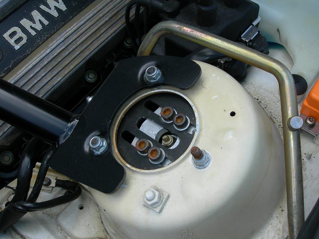

    think i finally found what i am looking for.
    Product SKU Price Camber Plate - Adjustable street&track
    E30cambersr
    $275.00
    New Product- Adjustable camber plates for the E30. These allow approximately up to 3 degrees of negative camber for the front suspension. These plates have sperical bearings encased in urethane to offer some cushioning. These are for dual purpose car that are street driven but are also used for track days and autocross. You can add negative camber for the track and adjust it back for street driving. They do not require drilling any holes and your strut brace will still fit. The bearings are easily replacable. Ride height will be lowered 1/8". These will work with factory type springs or 2.5" ID adjustable height coil over systems like the Bilstein PSS9. Priced per pair

      Those won't work for you, at full positive they will be the same as a stock bearing. I have them, I know. GC is your only option at this point because they're one of the few companies that make a plate with enough adjustment to go past the stock setting.
        http://www.ground-control-store.com/.../II=142/CA=183
        alright ill look at these now, thank god you said that I almost ordered the I.E. ones.

          I have both IE's an GC's. You can take out more of the negative camber with the IE's. Their drawback is they add about 3/8" back into the ride height. Jay from GC sold me one of the last sets of the old camber plates and I had to flip them and I had to grind away some of them to take out the negative camber. From looking pictures of the new GC plates they have removed the part that I had to grind away on mine. Also the GC plates allow for some caster adjustment. The IE's don't.

            thank you. that was good information. I actually wouldnt mind adding 3/8" to the front of my car because I've already blown an oil pan once. pretty sure i wil order the I.E. plates tommorow.

              aftermarket camber plates are designed to add negative camber for people who want to go fast on a track, auto-x, some backroad, or for r3v hard parking. why would somebody spend a ton of time and money designing a product that makes a car handle worse and look worse?
              You have a bent strut, a bent subframe, a bent control arm, or a bent unibody. BMW makes a product for you, it's called the crash mounts. You however want to look everywhere else for products that won't work instead of putting up the bucks to buy the correct parts.

              USUALLY most aftermarked camber plates remove overall stack height. that means that it will lower your car a little bit.
              You are confusing to me because you want to raise your car to give you the ability to run a smaller profile tire...
              Originally posted by joehasane30
              so basically the vorshlag wont do much positive for me?
              yes, that is correct, they will not remove the excessive negative camber that you have.
              once again, aftermarket camber plates are designe to ADD NEGATIVE CAMBER.

                        SPC Makes e30 camber correction strut mounts that work very well on the street for + or - camber, they are about $250 to $300.

                              The IE camber correction plates are copies of the SPCs with a cheaper bearing.

                                you want positive camber? just switch to e30 m3 5lug. without any camber plates or offset FSM, i had slightly positive camber even when lowered on H&R race springs...
