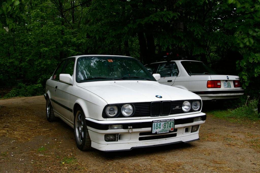

                  That would be a ryanG splitter.
                  Here you are my good sir.
                    http://www.r3vlimited.com/board/showthread.php?t=126550
                    And you're wrong. :p It's a custom piece (with undertray) made by 318isbmw. He makes normal splitters (not trayed and more conservatively sized) like RyanG's as well but with thicker material. Ryan's are great but having owned both I prefer the thicker one.
                      Sorry buddy, not his;)
                      Thanks Brendan...
                      I agree with Fidhle, just run some clips on it, and go slow over speedbumps and be careful, and you'll be all good. Also, its easy to take off, so if you know your gonna be in an area where it could get ripped off, take it off. I don't run mine on roadtrips and stuff like that just to be careful. Be careful, and the IS is way way better than the Rieger's hard material. Its pliable and works great, long as your smart about it.

                        If that's your car in your sig, I don't see how you've managed to have so many lip-related problems.

                          Yeah. My apologies for the conclusion jump. Palm to the face.
                          It looks good with the splitter. Nice work 318is.
                          As for ebelements, thats is just one of his cars. If you look through his threads you find the other. So do a bit of searching.
                          Pic of both. Nice cars man.

                            The pic britishbmw posted was the first incarnation of BMW318is's splitters on my car this past summer: 1.5" with full undertray. As you can see the lip had already been through a bit over the winter (with a RyanG attached) so downforce eventually owned it. The clips were overcome but I had the rear of the undertray bolted to my skidplate and I managed to escape with just having burned through the front edge of the splitter. I then bonded the RyanG to the bottom of that splitter giving me about a 2.5" splitter which actually had some noticeable downforce as speeds increased but that setup was short-lived as well. A pretty girl in the passenger seat inspired me to go much faster than was safe or prudent and the whole thing bit the dust this time, as the bolts had been replaced with zipties. My current setup is a 3" with undertray and is held in place with bolts, zipties and ACS-style splitter stays; it looks gay as fuck but it works and is solid! While parking last month I actually bumped a curb lightly and felt the car stop...
