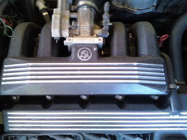

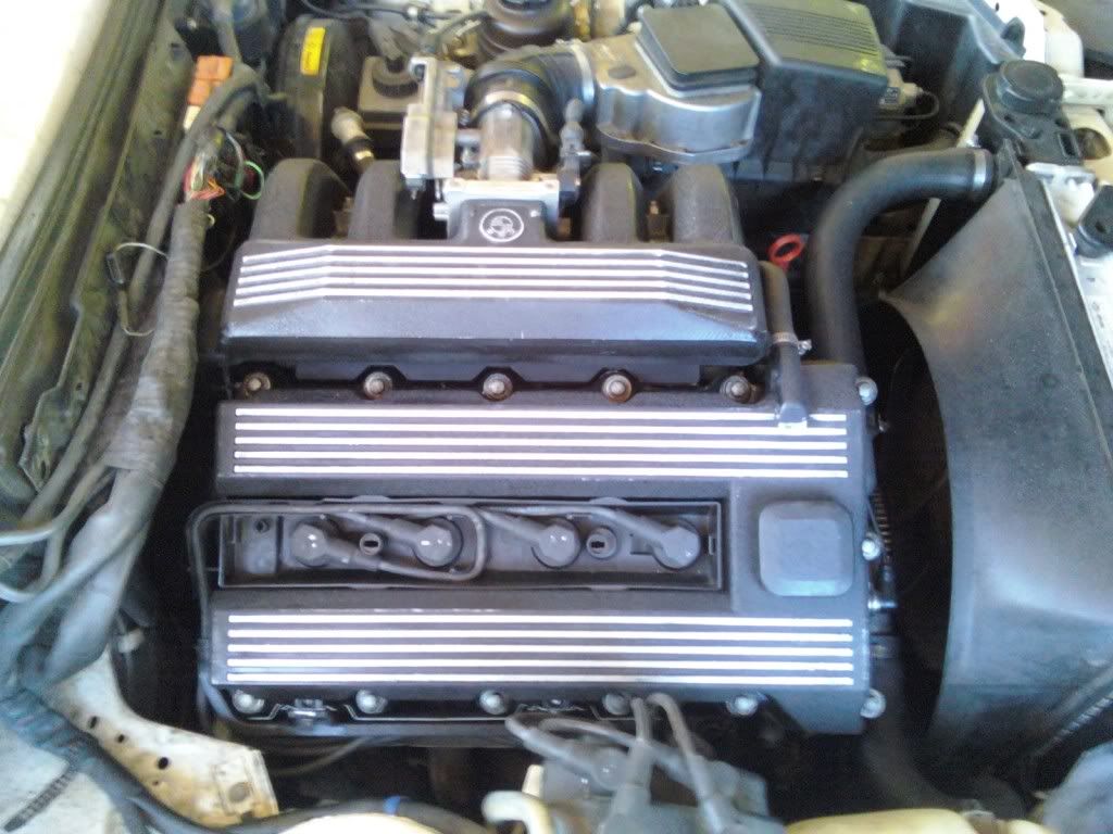

                              on a lighter note:
                              heres what my valve cover looks like now! at least something is turning out well under the hood....
