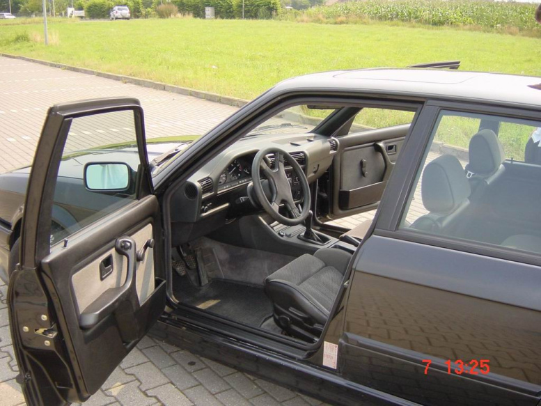

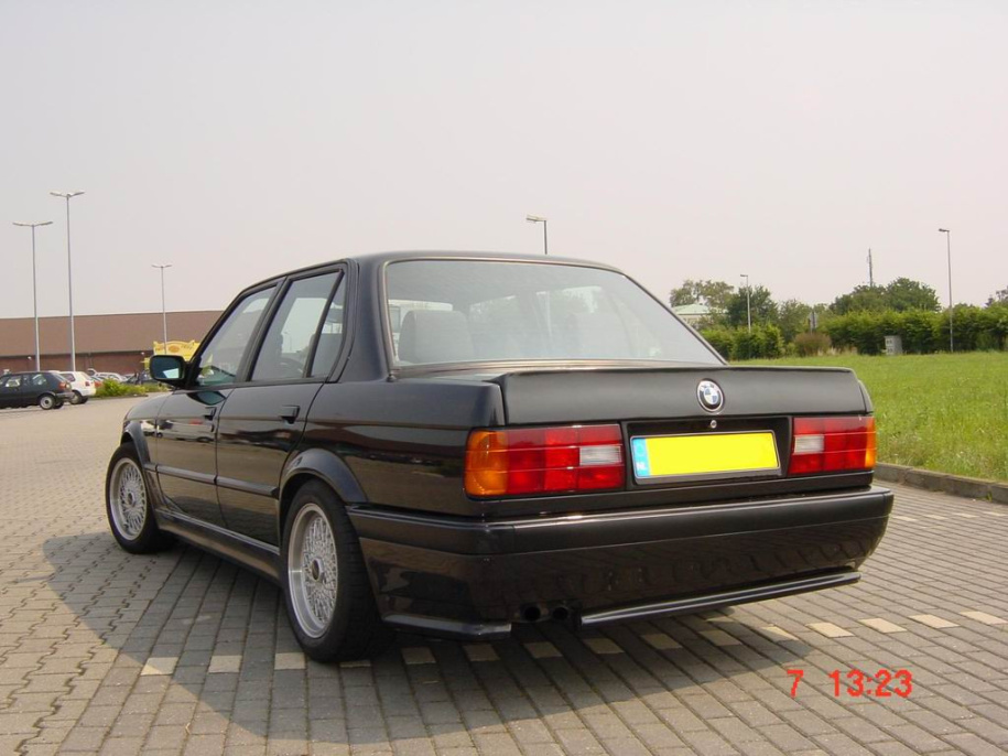

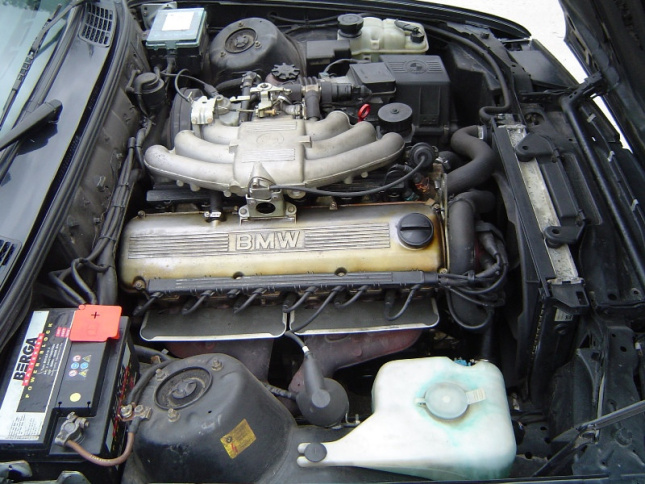

    The car as I bought it 17 years ago.

      Neat! Can't say i've seen a Kailine kit before. Gives me E36 vibes a bit.
      • reelizmpro
        • 9558
        Very nice. I haven't seen this kit before.

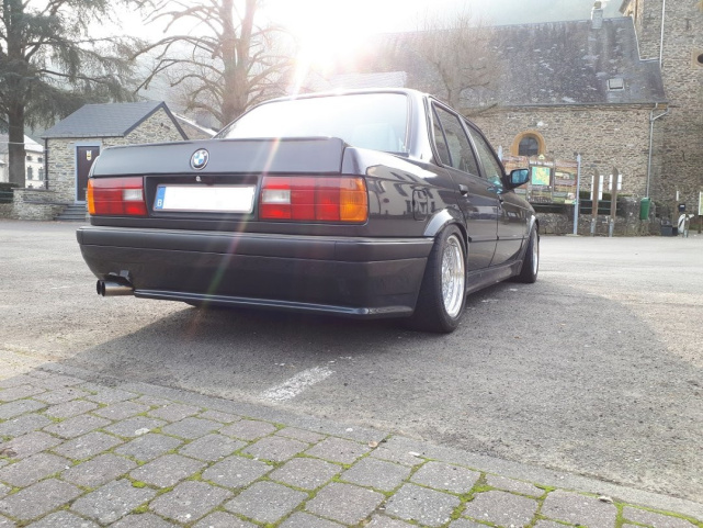

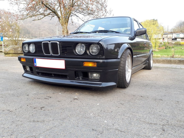

          Current state

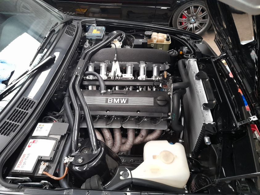

            Engine bay

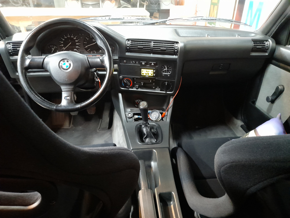

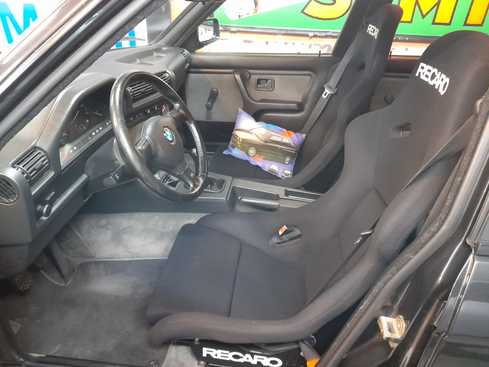

              Interior, analog oil pressure gauge will move as it will be visible on the can display

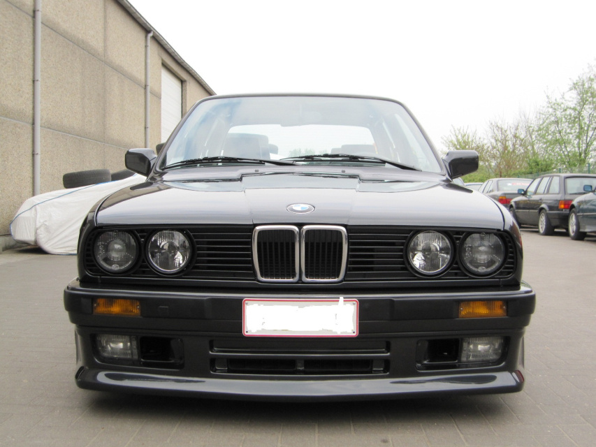

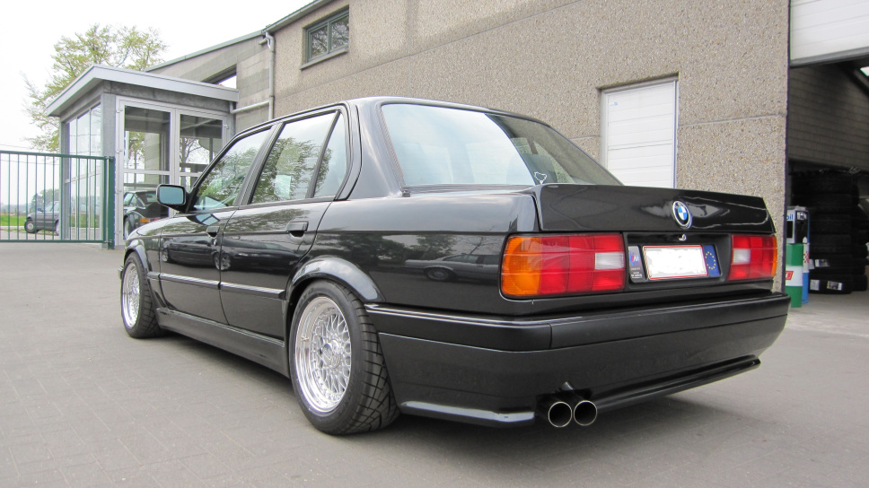

                  Some years ago after receiving new paint and some grille work. However, as the car is used for roadtrips, mountain driving and an occasional Nurburging Nordschleife lap, it's a challenge to keep the car in this state. The fact that I enjoy driving above cleaning also doesn't help

                    Is that trunk duckbill / lip spoiler part of the Kailine kit as well?

                      Awesome car, I feel like I have never heard of Kailine before. I like the rear and skirts, not 100% about the front bumper. Cool that you found such a nice example to start with, and have kept it nice through all these years.

                        car looks amazing , i def like the boot lid for sure ! what engine mods you did other than itbs?

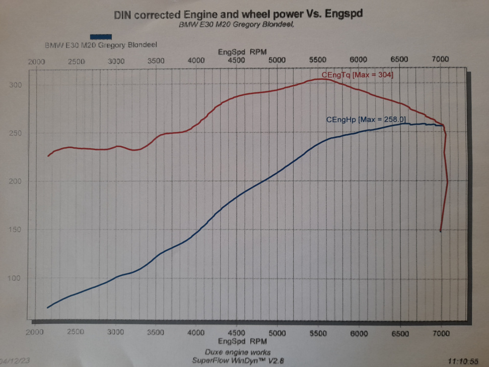

                          Engine is far from original. Currently putting 258hp and 304nm (crank)

                            Those are some quite healthy numbers. Whats the details on the build? Guessing its at least 2.8L if not a 3.1, at least 10:1 CR and some wild cam profile.

                              After break-in it was yesterday dyno time.
                              Lots of torque as foreseen, however top end flattens a bit faster than thought, apparently due to airflow.
                              Could be the size of ITB's which is on the small side, or the valves, or the head.. As it is a streetcar, I am not planning to change the setup as I don't want to lose torque in the quest for finding more hp in the upper range.
                              Anyhow the car is a beast
                              Pushed it once towards 7800 rpm, however limiter is set at a save 7000 rpm.
