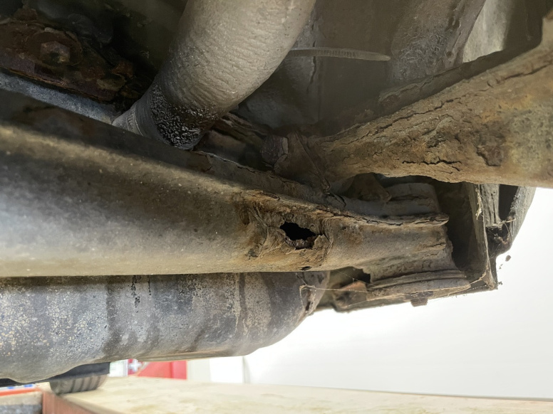

    Car on the lift i had a change to inspec it underneath. Nothing what makes me smile. But i didn't purchase new car from the dealership. It's 35+ years old gentleman and needs to be taken care of. And i was somehow prepared for that sight.
    There is no other solution than fix it. :)

      Both left and right corner was a just a big hole of rust.
      Click image for larger version  Name:	IMG_7030_1280x960.jpeg?2.jpg Views:	0 Size:	168.2 KB ID:	10085274 Click image for larger version  Name:	IMG_7036_1280x960.jpeg?2.jpg Views:	0 Size:	175.8 KB ID:	10085275
      Trailingarm doesn't look very good as well.
      Click image for larger version  Name:	IMG_7031_1280x960.jpeg?2.jpg Views:	0 Size:	176.0 KB ID:	10085276
      Rear subframe. Well in my opinion it needs replacing for sure.
      Click image for larger version  Name:	IMG_7032_1280x960.jpeg?2.jpg Views:	0 Size:	174.4 KB ID:	10085277 Click image for larger version  Name:	IMG_7033_1280x960.jpeg?2.jpg Views:	0 Size:	173.5 KB ID:	10085278

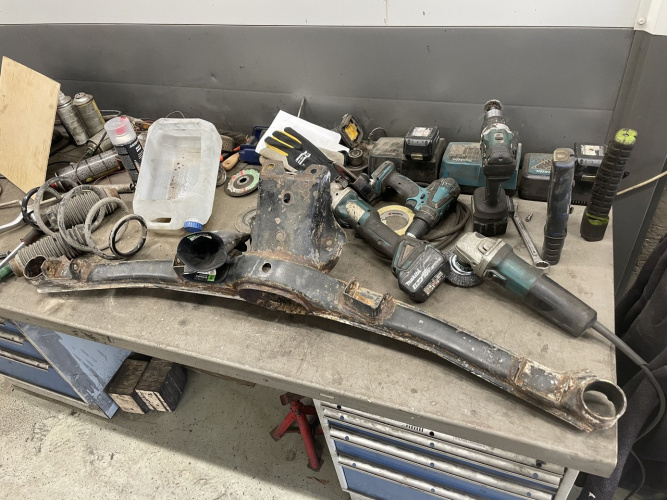

        Managed to find decent rear subframe and trailing arms. I will take them apart and send them to sandblasting and powdercoating.
        Click image for larger version  Name:	IMG_7038_1_1280x960.jpeg?2.jpg Views:	0 Size:	172.4 KB ID:	10085289
        Click image for larger version  Name:	IMG_7056_1280x960.jpeg?2.jpg Views:	0 Size:	154.7 KB ID:	10085283 Click image for larger version  Name:	IMG_7061_1280x960.jpeg?2.jpg Views:	0 Size:	177.9 KB ID:	10085284
        Click image for larger version  Name:	IMG_7062_1280x960.jpeg?2.jpg Views:	0 Size:	171.5 KB ID:	10085285
        Whats left of it. Everything goes to the scrap cause all what you see is unusable.
        Click image for larger version  Name:	IMG_7063_1280x960.jpeg?2.jpg Views:	0 Size:	184.3 KB ID:	10085286

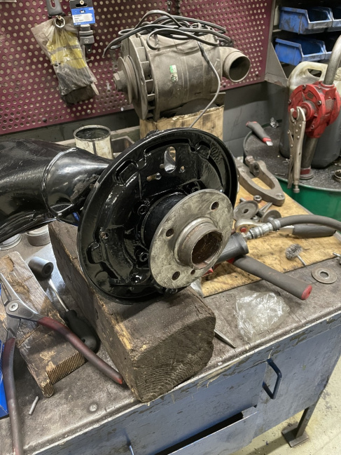

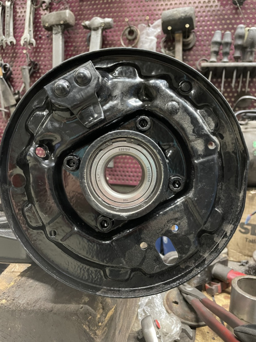

            Both wheelbearings where shot. What youre gonna do ? Get the new ones made by SKF.

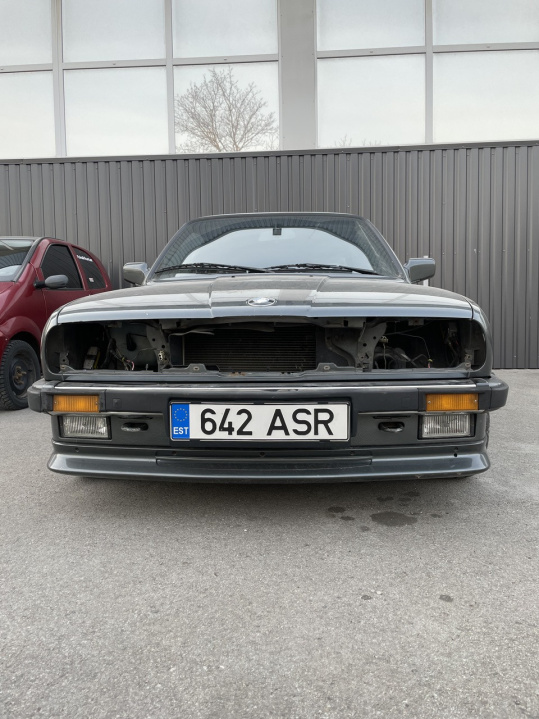

                    Car is back on its own wheels but not drivable yet.
                    Click image for larger version  Name:	IMG_7247_1280x960.jpeg?2.jpg Views:	0 Size:	183.4 KB ID:	10085410
                    New original heatshiled and muffler attachment clamps from Bosal.
                    Click image for larger version  Name:	kuumaplekk.jpg?2.jpg Views:	0 Size:	182.0 KB ID:	10085407
                    Click image for larger version  Name:	p6hi.jpg?2.jpg Views:	0 Size:	204.2 KB ID:	10085408
                    Exhaust fitted. Also made by Bosal. It was the most wallet friendly solution for me. And i dont need huge noise making exhaust so this is ideal for me and what is more imortant, it looks very close to original one.
                    Click image for larger version  Name:	summuti.jpg?2.jpg Views:	0 Size:	202.8 KB ID:	10085409

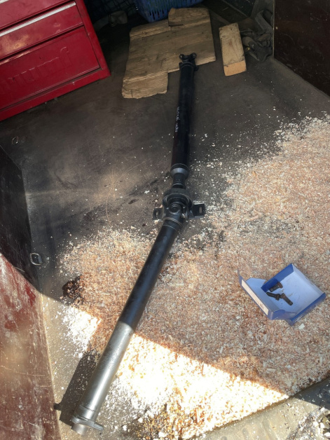

                      Propshaft got new u-joints, balanced and painted. Ready to be fitted.
                      Click image for larger version  Name:	kardaan.jpg?2.jpg Views:	0 Size:	177.7 KB ID:	10085423

                              One morning i drove to work and smelled petrol but could find anything that leaked. But when i went to the smoke break i noticed some petrol stains under the car. I was pretty sure that some of the fuel hose or fuel line gone bad. What came out, fuel pump decided to pee itself. Great! At that time i worked in a carparts store and managed to find new pump from our warehouse. Just a friendly advice, dont buy Meat & Doria stuff. It squealed like a pig. But i had nothing else at the moment so i had to pleased that i even got something.
                              Fuel pump bracket almost rusted away. I had to use zipties to make it stay there.
                              Trust me, i didnt want to put it back like this but had no choice.
