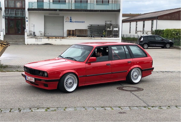

    New here, but thought I would introduce my new car.
    I looked for a while for an e30 Touring. I live in the US and while there are a few here, they are either tatty or crazy money.
    So I found somebody in Europe who could look for one for me.
    I've owned plenty of cars in the past, but only two BMWs. An e46 330i in the UK for a short time - bit of a basket case and a bad choice. Then I had an M135i in Switzerland, which i absolutely loved but treated as a get-in-and-drive daily, not something to tinker with as you are not allowed to modify cars in Switzerland.
    I currenlty have an R55 mini clubman JCW which this will replace as my daily - so while I want to work on it, it has to be fairly reliable.
    My original plan was find something with a tidy body and then swap the engine to something else. I have a miata track car that I have completely rebuilt (including the engine) so thoguht it would make a nice project.
    First plan was an N54/55 or an LS of some kind , but as I started looking at it and learning more about BMWs I relised that the N54/55 would be hard. I also learned that there are other BMW engines that as not as much work as the N54/55.
    So the M52 (or other variants) seemed most sensible.
    I also noticed that there were lots already converted in Europe for not a lot of money. Now buying somebody's converted car is always a risk... but I took the plunge and bought this:
    It is still on a boat at the moment, and I've never seen it in the metal. So it could still be a complete disaster - but we will have to wait and see.
    It is a bit stancy for me, so there will be some changes.
