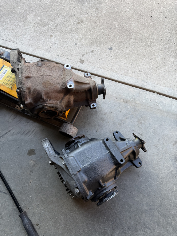

                        I am half way through installing a 3.25 LSD in the car!
                        its from an E28, already had an e30 cover and new bushing installed, I had to swap my output shafts and speed sensor. Put new output seals in while I was at it, feels smoother than what’s coming out. Should bring as much party to the pedal my 2.7 can manage! Haha. The removal of the old one got me a bit cocky feeling as it came out drama free after work last night. Went back at it after dinner and got my ass handed to me. I got 3 of 4 bolts in but couldn’t start then cross threaded the 4th. Arghhh… pulled it back out cleaned up the threads and at 11pm called it a night….
                        let’s see if I can lift my arms over my head today… will update on the install and test drive when I can.

                          3.25 & a tune will make the eta VERY enjoyable!
                          Theres a great thread in the M20 forum about building a Hot Rod M20
                              Yeah that'll get ya! Hard to line things up with the subframe still mounted.
                              I went through that too, then converted to a stud kit.
                              Welded the stud for the damaged hole in place while I was at it.
