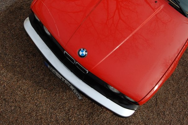

                    Picked this up from Court M3 this morning:
                    It ain't perfect but it is in better overall shape than my US Valence on the car. And you can't beat the price, free. With a little elbow-grease and paint (and filler) it'll be perfect. I just hope it dries out sometime soon so I can get crackin' on it...
                    Thanks Court!
                    I also scored a set of Euro Bumpers from Vlad and I got an OEM Aero (Pfeba) front lip from Mitch M.
                    ...it is all comming together!
