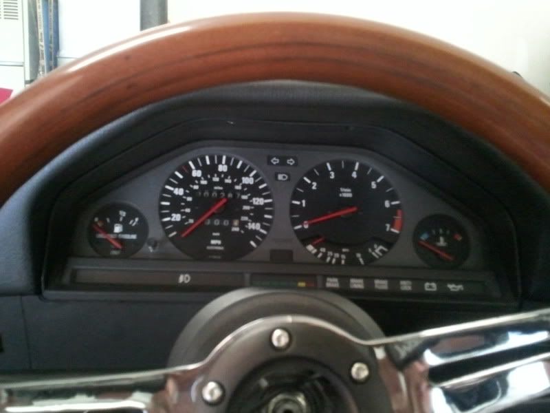

                                fixed up my cluster a bit...
                                baby sleeps inside now! gay cell pics w/e
