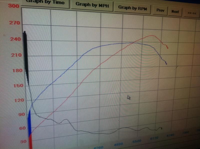

                        I was able to get some more tune time. Things are looking up as my goal for 300+ whp is now closer than ever.
                        blue is torque red is hp. here we are only at just a little over a bar of boost. AFR is below in black. Its a little rich, better safe than sorry...
                        its falling flat on its face around 6100 revs. the m42 throttle body is just not cutting it anymore. It cant support enough airflow to sustain the engine at anything above 6. I will be making adjustments for a m5x throttle body. A whole new intake is in order soon.

                          Nice results. A new manifold/tb should work well.

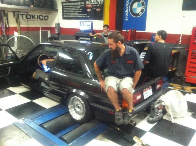

                            A few things happened that we didnt expect. First off the car would not keep traction. We had to air the rear tires down and even with 3 full size dudes sitting on the trunk it still managed to spin tire. The torque my turbo is creating is quite impressive for an m42.
                            the rollers are also small and pretty slick. We managed to make it work

                              Is your cam timing stock? If so you can retard the intake a few degrees for dome more top end.
                              You shouldn't be losing traction on the dyno with that level of torque. I know smaller rollers hold less torque. I havent used a dyno with two rollers like that though.
