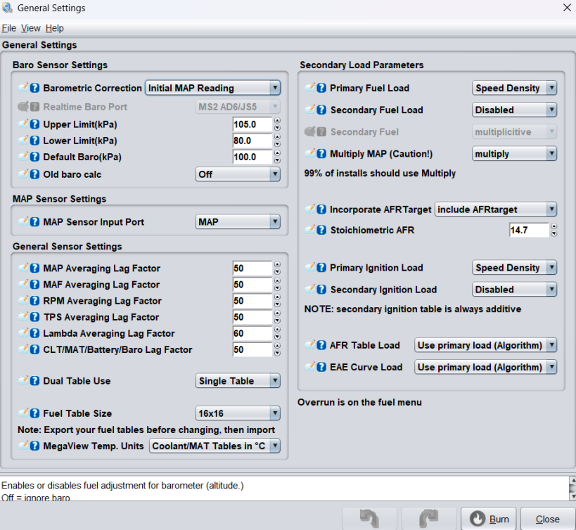

                  • baltic_wh4le
                    • Jun 2024
                    • 5
                    #774
                    I am using a KDFI 1.4 (MS2Extra). There is a massive misfire, but I have gotten it to idle. After hours of tweaking different settings we gave up for tonight (its 2am lmao).​ We tried the priming pulse you provided but flooded the engine haha. Below are the current tune/things were I think the problem could be. The misfire is MASSIVE, almost like those cylinders either arent getting fuel or spark, yet spark is definitely there(havent checked fuel yet) and with original ecu the car runs fine. Thanks! Gonna crack on tomorrow!
