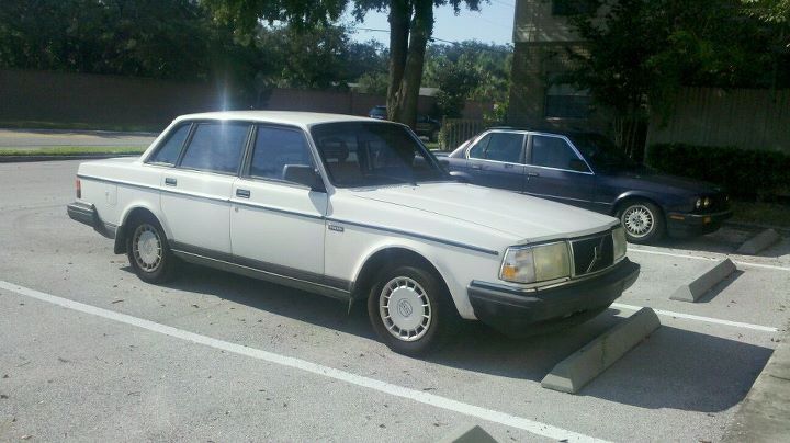

      we picked up a volvo 240 yesterday.
      so cool!
