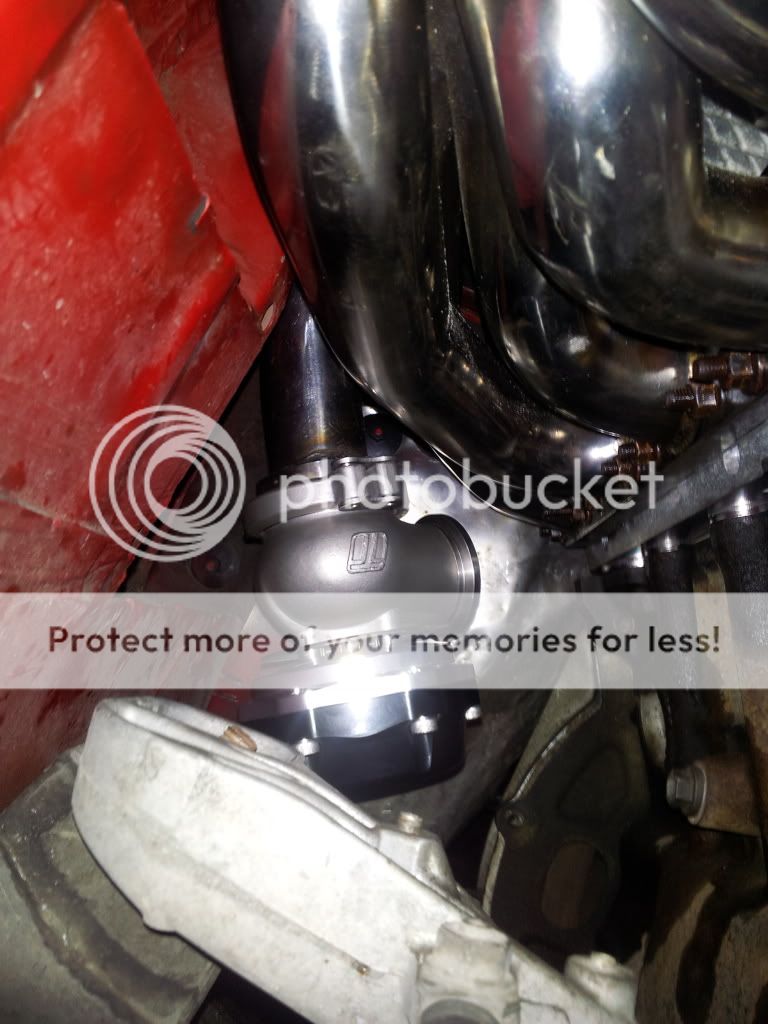

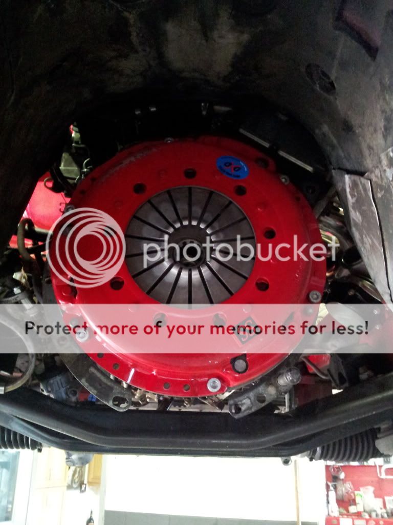

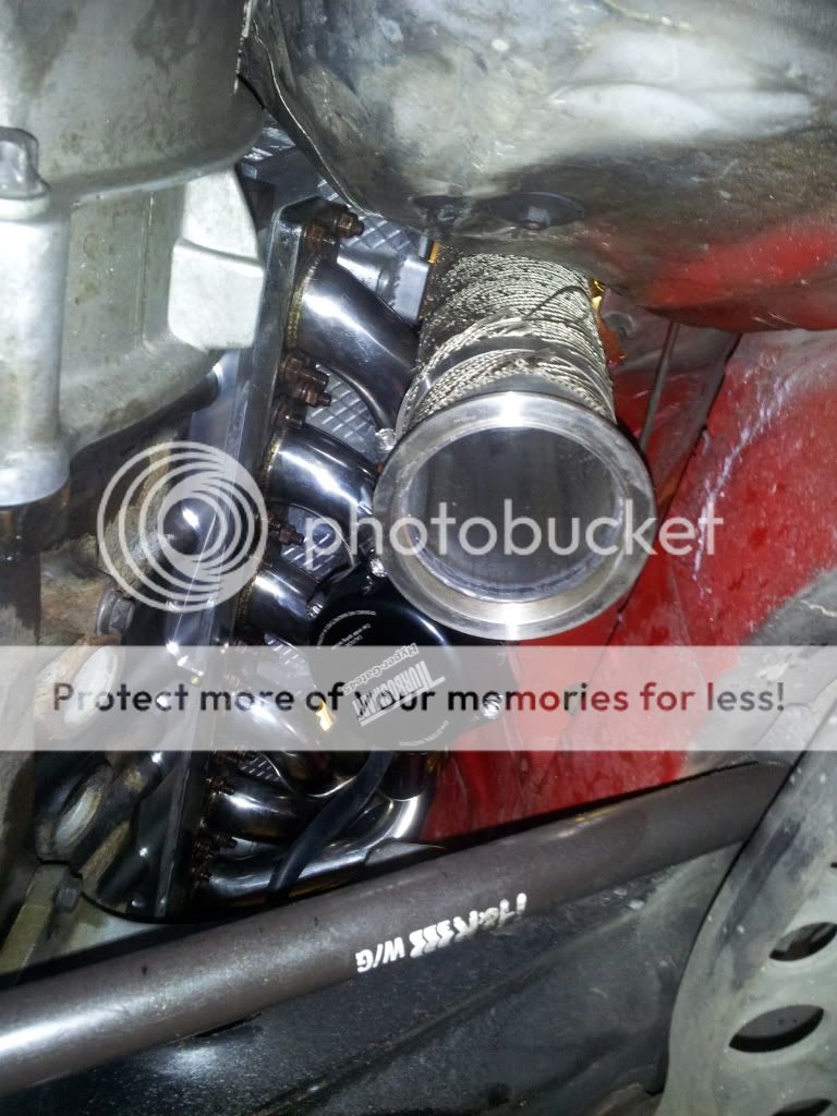

    E30 S50 Turbo
    First off thanks again Steve(blunt) for all the help and for the parts.
    Car was a 91 318is.
    Now has a S50 with ZF and uuc evo3 ssk+dssr.
    Gc e36 for e30 coilovers 450f 700r.
    E36 m3 front brakes, e30 m3 rear.
    Hawk Hps pads.
    Stainless braided brake lines.
    Ate super blue.
    H&R sway bars.
    Kosie K1' & in the process of refinishing some e39 style 5'.
    Turbo build parts,
    Blunttech/good n tight manifold & downpipe.
    Garrett T3/60-1 .63ar turbo.
    TRM 60lb blow through tune.
    .140 mls.
    Arp 2000's.
    Turbosmart hypergate 45 external wastegate 7psi for now.
    Synapse bov.
    Southbend stg 3 clutch.
    Blueapplesoda Pnp innovate lc-1 wideband.
    Autometer boost gauge.
    This is just a test fit with the Style 5' so ride height is way off and tires will be proper size when they are refinished.
    Turbo build pics,
    Head off Havnt cleaned the block yet.
    Head back on and being torqued,
    Im almost done just waiting for the proper turbo oil feed fitting and the rallyroad steering column gauge mount. Then its off to get the exhaust made. After that is done im sure you can figure out whats next
