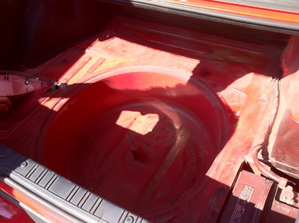

      Got around to doing some work this weekend. I pulled up the rear carpet only to find a bunch of surface rust. Nothing bad, but I figured that I might as well fix it.
      Using a dremmel and a wire brush, I got most of the mess off.
      Decided to pull the battery tray only to find more surface rust and a small (dime sized hole)
      Some deeper spots sanded and filled with bondo and rust inhibitor.
      Adding inhibitor to more places
      Also did the battery box:
      BEFORE:
      AFTER:
      The trunk completed
