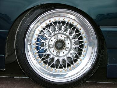

    The E34 offset is different from E30, you'd definitely have rubbing problems no matter how streched your tire is. For those interested, www.rimpro.com makes QUALITY replica m-parallels to match many different BMW offsets. Check it out...
    -JK
    The e34 offset is the same as e30 M3s...~19mm
    Just ordered my M-parallel replicas for my non-existant e34 (same ones as 325Projectz')
            -JK
            Many people run e34 wheels on e30s. The only difference is the hub center bore and offset at times depending on the wheel design. You need a pair of hub centering rings to fix wheel shimmy. You fix the offset issue with either a spacer or machine down your anti-rattle clips.
                    Take a look at the numerous number of e30s on M-parallels, Style 5s, M-system wheels, etc.
                    Your thinking of E39 wheels, the center bore on the E34 and E30 M3 are the same and the offset is only slightly off but no biggy. The real issue is the size of the tires.
                                No matter how many times I see an E30 M3 with M parallels I still do a double-take. Those rims are awesome, especially 18x8.5's.
                                :dot: bah, My bad, e39 and e34 confusion indeed. Thanks for the correction!
