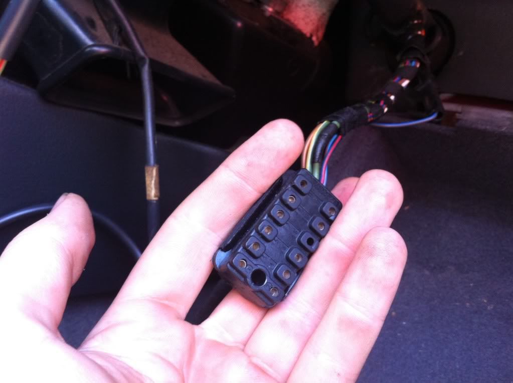

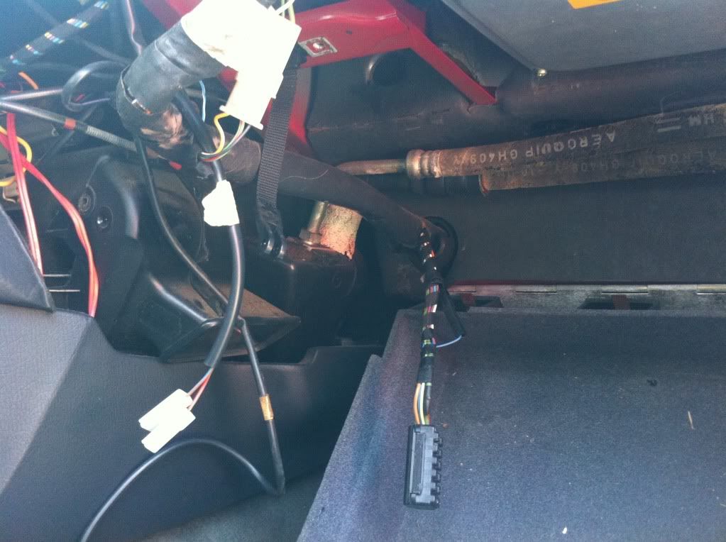

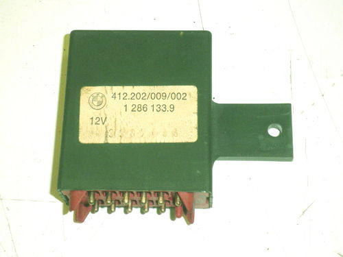

      Originally posted by James Crivellone
      Any 021 or 027 ECU will run that motor, the 528e would have come with either one depending on year.
      They are the same except the 027 has a removable chip while the 021 does not.
      Sitting near the ECU should be another box, usually green however rebuilt ones can be blue. This is the idle computer (Motronic 1.0 used a separate computer to run the idle control valve) Make sure you have one in there, that could be another culprit.
      Looks like this:
      im guessing this is where it was? looks like i need to get one!
      86 325es
      Santa Cruz, CA
      • James Crivellone
        Head Janitor
        • 6305
        #48
        Yep, you need an idle computer! Back to the wrecking yard you go!

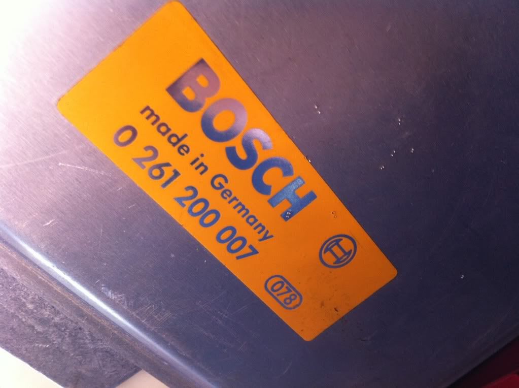

            this is the DME

                this is the DME
                Wow you went mega old Motronic 1.0. Yeah that should still work, have not seen a 007 in quite awhile

                    #54
                    as long as it works. i can get a new one later.
