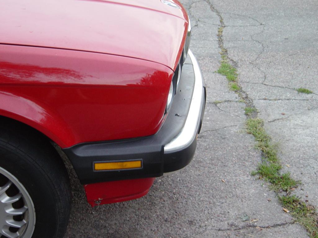

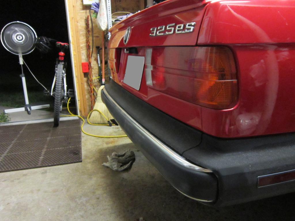

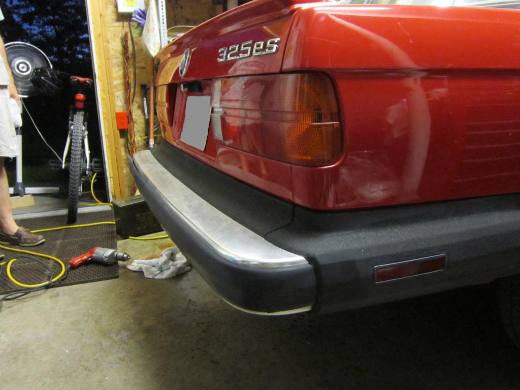

              Bumpers tucked!
              Tucked the rear bumper tonight. Fun! As in the bumpers bumpers bumpers thread, you get a jet of high pressure gas when the drill bit breaks through, then when you pull the bit out you get a blast of really stinky clear blue hydraulic fluid of some kind. A bit like ghostbusters, sprays everywhere. The garage stinks - do this outside!

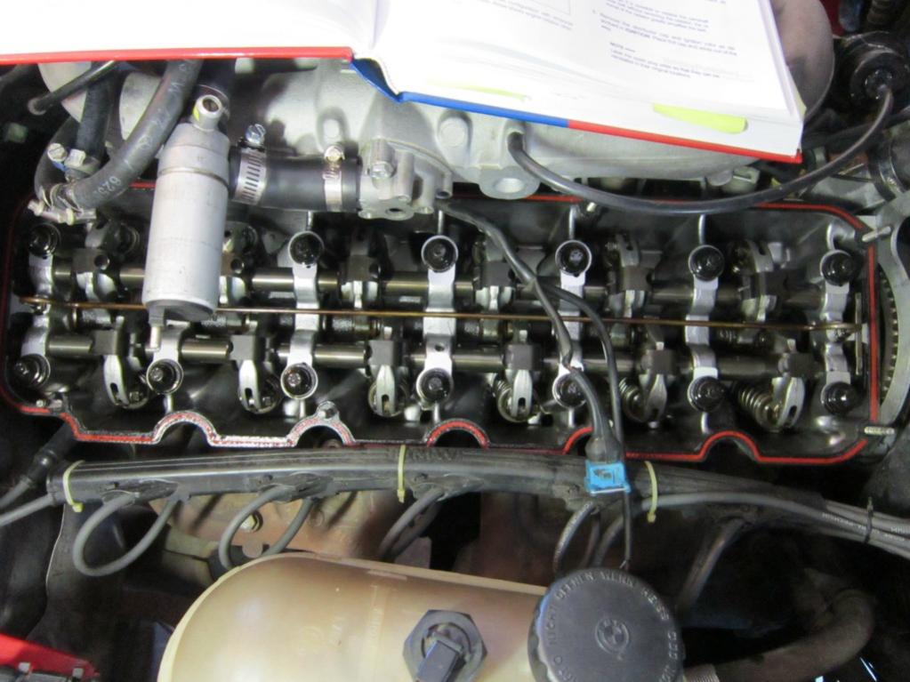

              We sent the injectors off to get refurbished, and tomorrow we're replacing all the cooling and remaining vacuum hoses, as well as the fuel lines down underneath the intake side. While it's apart, we'll put in the new waterpump and flush everything. Also need to test the cold start injector to see if it's leaking.
              Pretty clean head - but then it was replaced two years ago and only has 5000 miles on it. Valve cover gasket was just jetting air when we did a smoke test. Mostly through those rocker shaft rubber blocks.

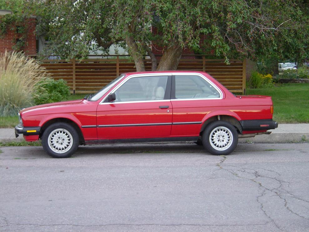

                        Got the motor buttoned back up again - all new rubber everything & anything, except for power steering and AC hoses.
                        Starts right up, which is nice, runs smooth, new injectors by MEPEH are great.....still a couple of idle cycling issues. There was a huge leak at the valve cover plugs - we'll do the smoke test again and find the problem. ICV tests out correctly per the book and advice here, but...sure sounds like a bad ICV cycling, or like every 3 seconds a switch is shutting off the engine for a microsecond.
                        Maybe related - when you rev the engine and drop the throttle, it acts like it's just going to shut off, then it catches itself at about 500 rpm and bumps back up to idle.
                        Tucked both bumpers, lost the big IS spoiler. Have a used euro lip coming from a r3v member.
