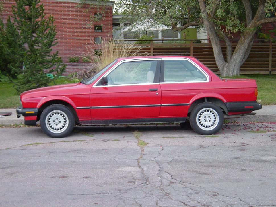

          Replaced the big ES / IS spoiler with a euro lip last night (thanks GT BMW E30!). I like it with the tucked bumper.
          As soon as we get it running well, we've got all the suspension, steering, & brake bits to start on. H&R sport.

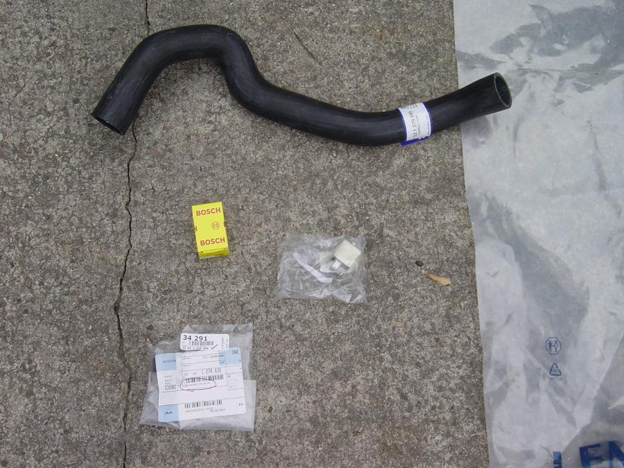

              Alternator blades cut our brand new radiator hose. Most sensors and relays have been changed.

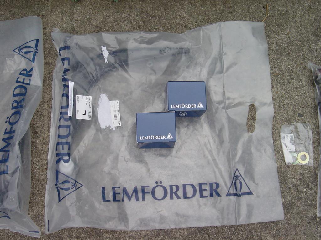

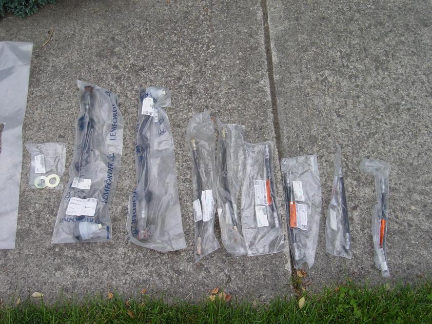

              Tie rods and brake lines.

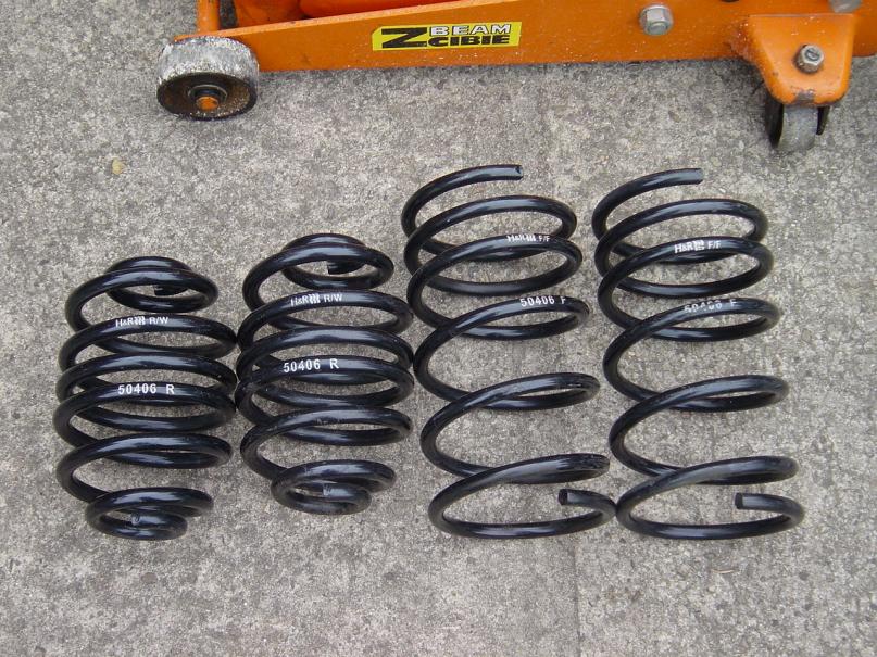

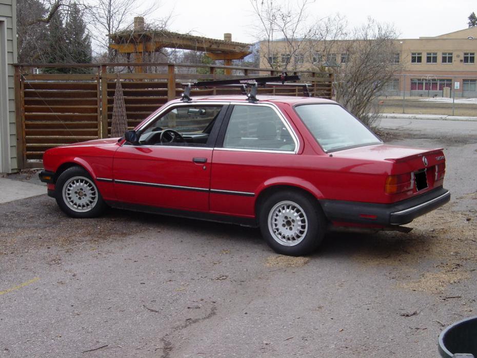

                  Here he is, just rolled out of the garage with the new suspension. Hasn't even settled yet. It's been nasty cold here, and school has been really busy.
                  This is with H&R sport springs, E90 drop hats, and stock spring pads all around.
                  All new OEM control arms, bushings, sway bar links, tie rods, brake lines, etc. Flushed the brake system.
                  Drove it 20 miles to charge it up and it drove straight down the road, no pulling. Must have lucked out with the steering measurement. Alignment this week. After it settled a bit, it looks good. Not too low for everyday street and real roads. Even makes bottlecaps look decent.
                  Ran perfectly, never missed a beat! Steering tight, brakes solid.
