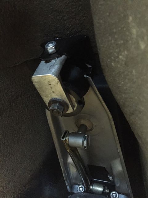

    A guy on myE28 forum said he used an aluminum angle and an E36 trans mount.....
      Clever, looks like that should work pretty well! I wish I had measured mine, if I hadn't found one I was just going to make one out of some metal bar stock. Shouldn't be very difficult at all if you end up having to fab one up, and not like it's supporting very much anyway

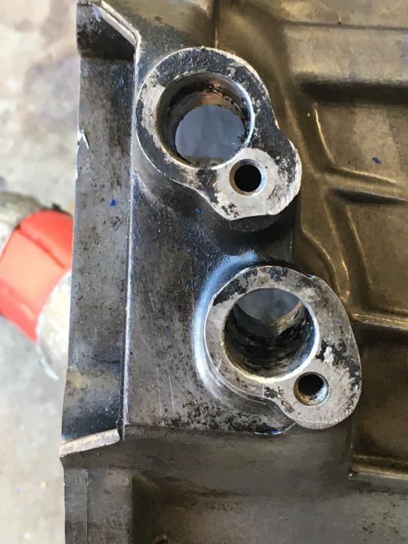

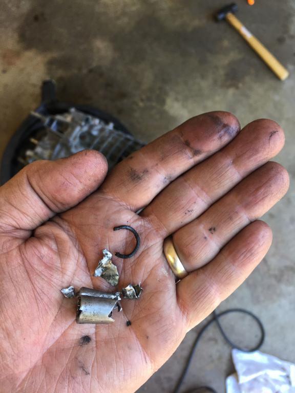

              I started working on the crank position sensors, which were stuck in the bores because the plastic started to melt. Slow and careful, tap away with a punch, a big punch, and a tiny screwdriver, trying not to gall the aluminum. Then I used a fine rat-tail file and just pushed once against the black plastic bumps. I believe there's a small ledge inside the bore, where the upper plastic part of the sensor bottoms. I'm trying to get that bit of plastic out of there without ruining the step. Tiny taps.
              Is there an o-ring in the bore on the CPS? Interesting that it mostly made it.
