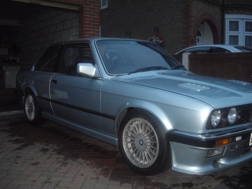

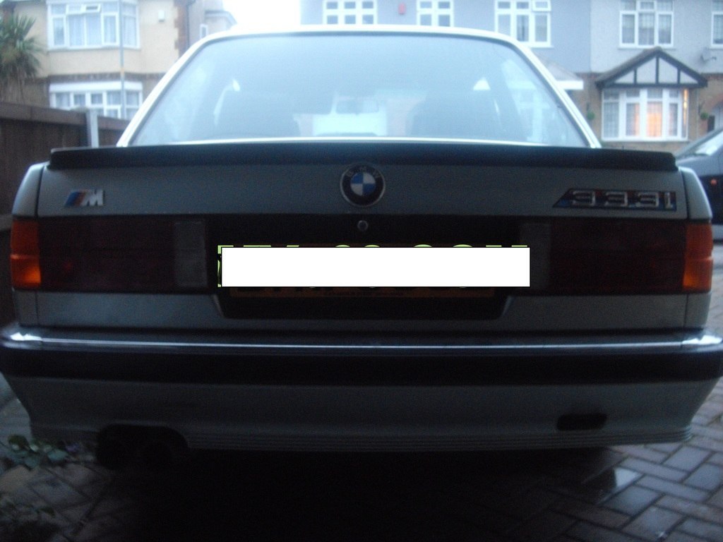

    My 333i turbo
    Just found this forum here is a picture of my 333i

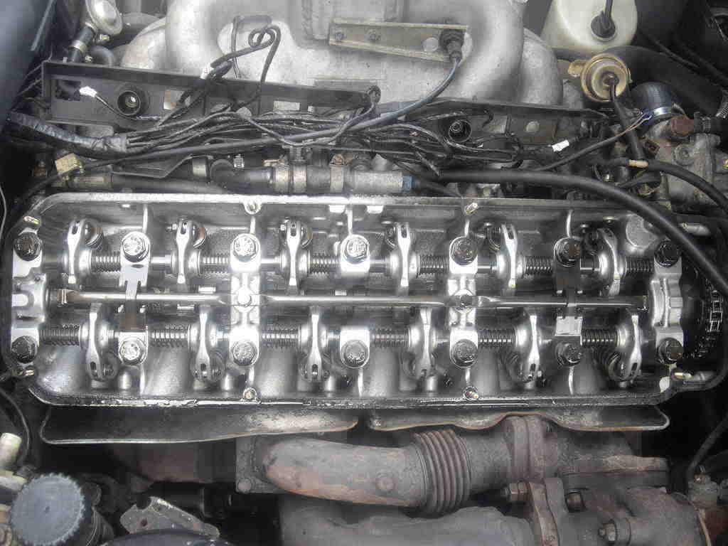

      Inside the rocker cover and rear end

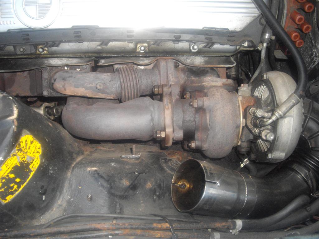

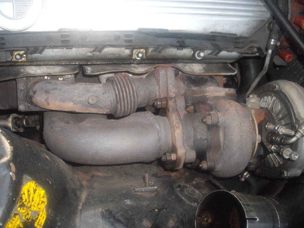

                      What turbo manifold and downpipe is that? Looks like a nice setup.
                      • scoobydo
                        • Sep 2013
                        • 137
                        Manifold is part oem bmw that has been flipped to make top mount. However this causes access issues to the plugs. Have owned the car since 1999 but it has been dry stored for 13 years. Passed MOT on first attempt and now going over a few things on it. Went to change the plugs for the first time and this is when I realised the access issues. Toying with changing the manifold to remove this issue but then obviously we have a major plumbing job to do and will need a remap which then leads to more issues as the ECU is a Zytek with limited support.
