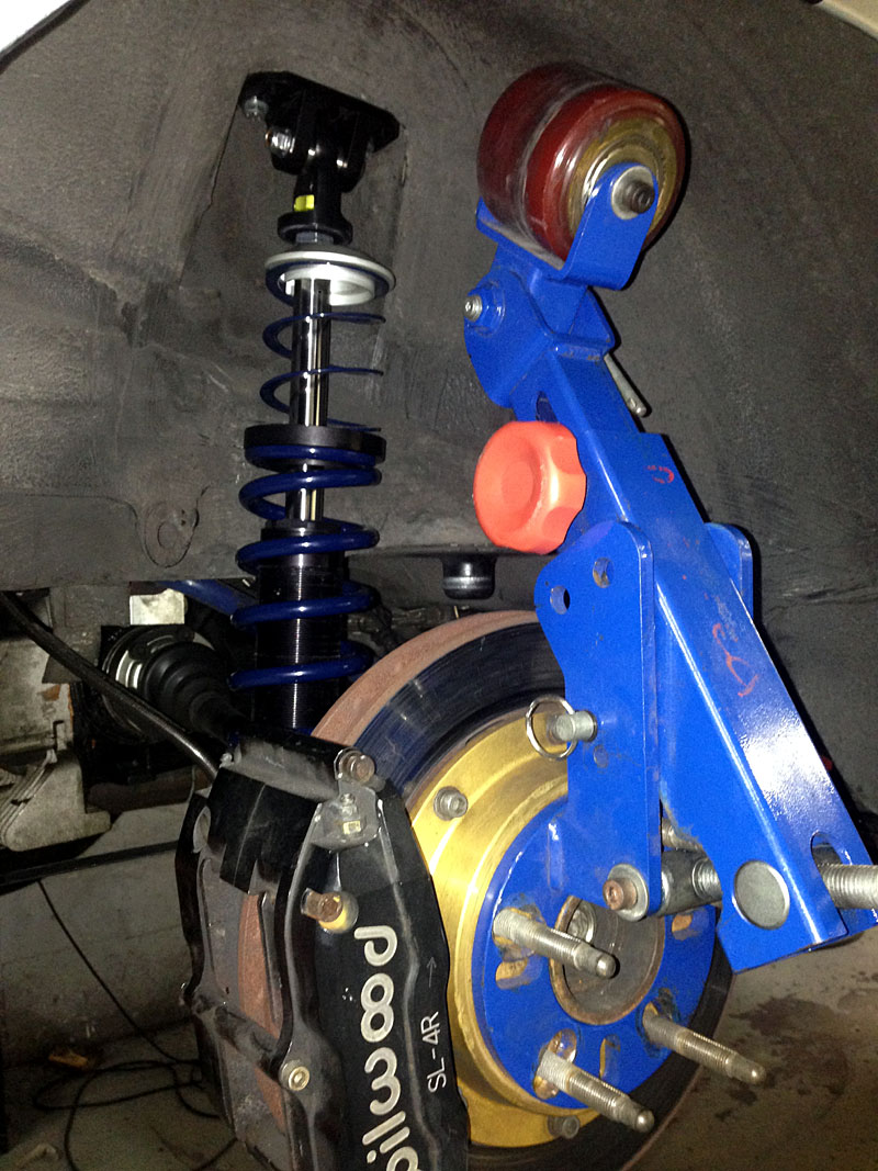

                              A few days later UPS man brought a couple of boxes and I got to give them a test fit. Besides the visual design that I like, I wanted these wheels because I was pretty sure I could run them without a spacer, and they are wider than an 8 inch wheel so I could run a fairly wide tire.
                              Test fit:
                              Untitled by ericandshovin, on Flickr
                              Clear's the Wilwood brakes just fine. This is usually where spacers are needed, to space the back of the wheel spokes away from multi-piston calipers.
                              And it doesn't rub the struts. Apparently another set of wheels I have does!
