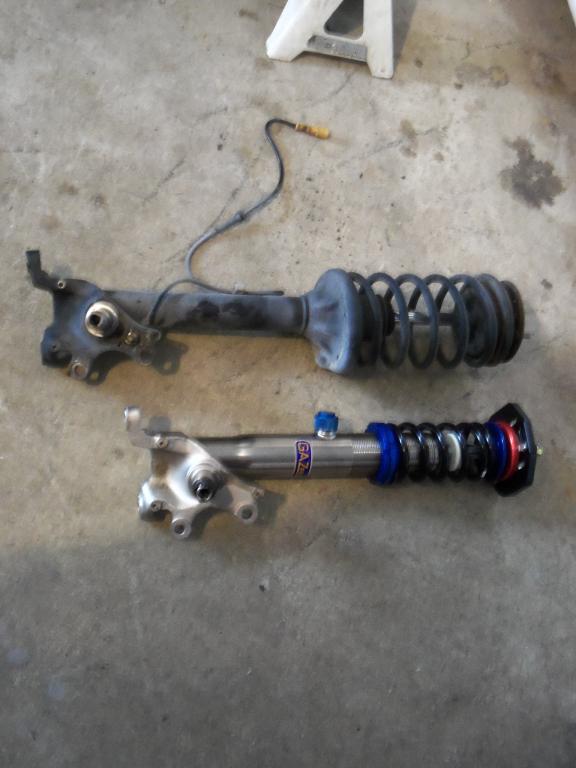

      Nice work!! I like the comparison pics of the new and old front suspension. Here's mine. Big difference.

                    Are you running gc coils without camber plates? How low are you and do you rub? spring rates? sorry for all the questions camber plates are last thing i need and if i can get by with out them for a while I will. Car looks great though
                    1991 318i 4dr slick top
                    Mtech 2 turbo restoration
                    • dirtbag30
                      • Apr 2013
                      • 678
                      questions are no problem, haha and thanks!
                      GC coils, Koni yellows in the front and bilsteins in the rear.
                      bought used/new(not a scratch on them) from a member here. No camber plates. the last thing on my list too.
                      i was told the spring rates are 375 front and 475 rear. which sounds stupid soft. but they are actually very stiff and maybe was a typo on the P.Os part.
                      the ride is almost too stiff for me, im considering selling them and throwing H&R race springs on.
                      im all the way slammed on the coils in the front, on un-shortened housings. never bottomed out yet, although i rarely drive the car on bad roads. and have never rubbed.
                      and about three threads up in the rear on the adjuster.
                        If you think those spring rates are too stiff, you're not gonna like the H&R Race.
                            Get konis in the rear, i bet your ride quality improves. Those rates are pretty mild.
                                Hmm interesting I got Koni sport adjustable in all four corners with Gc coils 450/650 I wonder how it will ride. Then again I'm m30 swapped so I need a little bit stiffer ride.
