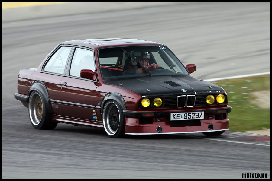

          Originally posted by 5150ct
          This is the look im going for with the finished car, but with the flares and hood painted same color as the body. Anyone know what flares this car is running? KA?
          I believe those are Ireland Engineering flares.

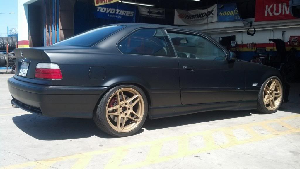

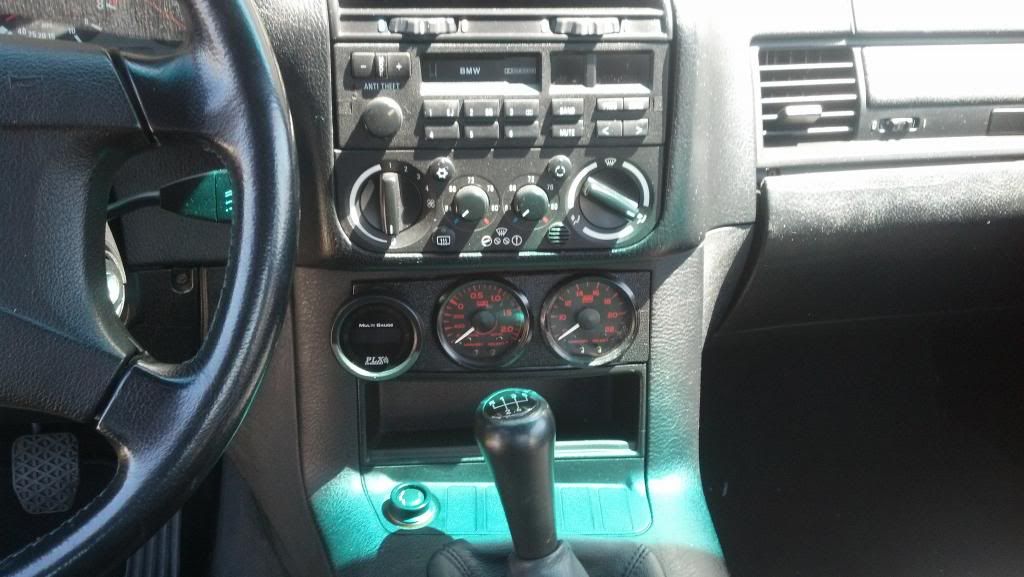

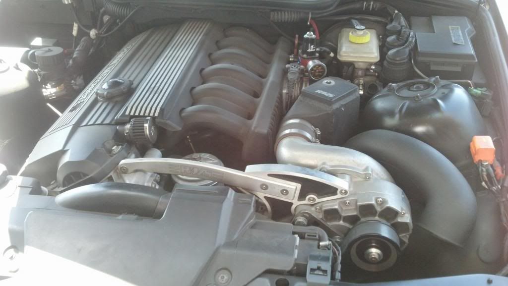

              here are some pics of my other project car:
