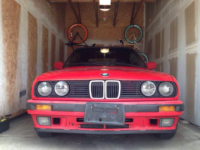

          Remove the front plate holder that's crooked! Looks great besides that, tell the wife congrats!

              there's a rubber bumper on each front corner of the hood, located on the core support. twist them out to raise the front of the hood. you can also raise the latch inside the core support if it's pulling it down. the rear is adjusted down with the bracket things. side to side and front/rear of course is the 6 hinge bolts on the hood.

                  if you are talking about the wires behind the valance those just clip into the valance itself. if you dont have oem clips like me you can use zip ties

                        Thanks for all the help everyone. The hood is sitting nice and flat now on all four corners

                          Also the wires do have a clip, I'll just look for the hole to stick it in on the valance hahaha

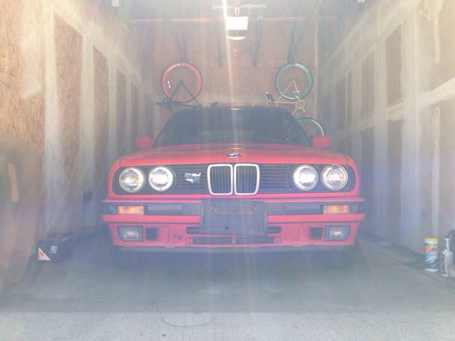

ID:	7168007installed the depo headlights today
