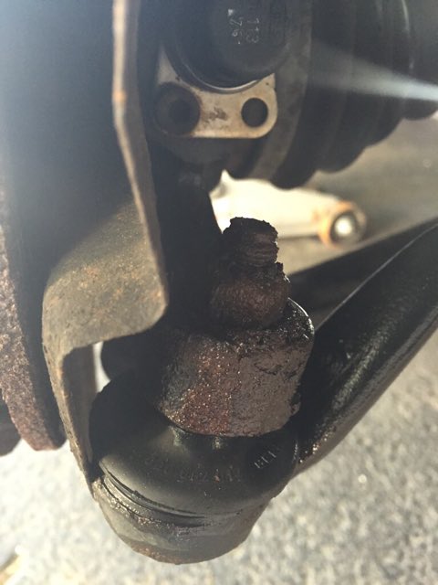

                    So I'm attempting to change the tie rods right now and I cannot get them out. The outer tie rod has a 17mm bolt that connects to the hub. When I ratchet the 17mm the thread spins along with it. I tried to us some vice-grips to hold the thread in place but that only stripped the thread. I feel kind of stuck at this point. Click image for larger version

                      Hold the bottom of the tierod up with a jack. Also DON'T use a pickle fork - hit harbor freight and grab one of the ball joint separators
                      http://www.harborfreight.com/3-4-qua...tor-99849.html

                            I'm having the hardest time with this it's embarrassing. I managed to get the outer taken off the hub, but seem to be stuck on the inner. The securing plate almost seems to be welded in there. I've taken a chisel to it. I've hit it with a screwdriver. It looks separated and shouldn't be holding the inner in there, but there must be some sort of seizing. Click image for larger version
                            I cannot get it to budge. All I am getting is play in the rack (yea I gotta replace it...)
                              Thanks this was super useful information for the drivers side. took me about 10 min to finish that side.

                                I have a handful of pictures, but lets just say that the tie rods were one thousand times more difficult then they ever should have been. I have done plenty of tie rods and never had this much of a problem with it. Needless to say, I am embarrassed at how hard the passenger side was.
                                I ended not being able to get the ball joint bolt out since the thread just kept spinning. My first reaction on this was to use the vice-grips (before bradnic gave his great advice with the jack) and I ended up stripping the threads. At that point i figured I would just saw off the thread which worked with the outer tie rod. Then the inner was a huge pain in the ass. I eventually got the plate bent back with a chisel set and an inner tie rod tool. After that it was smooth sailing, but seriously the biggest PITA i've had working on a car next to the steering rack in my Audi.
                                I love cars though. I'm excited to keep working on the BMW. I took it in for an alignment today. From my initial observations with the new tie rods, they really did tighten up the steering feel a lot. I had A LOT of play in the steering wheel because both the inner and outer joints were completely ruined.
                                Steering coupler and rear strut mounts are next.
                                Thanks for all the help and listening to me bitching about it.
