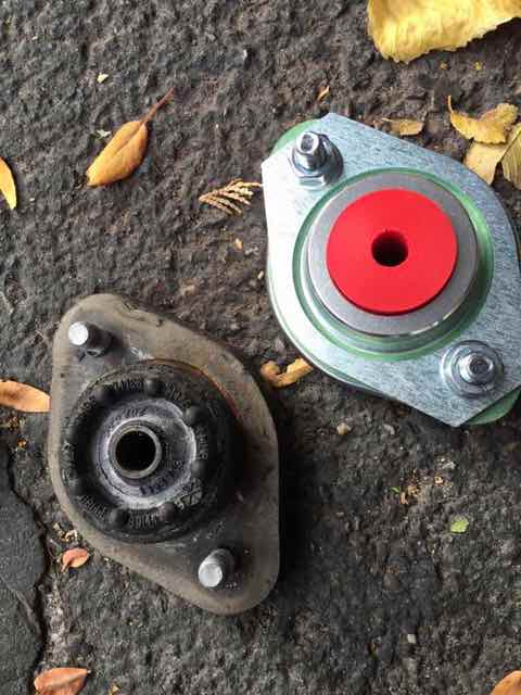

    I got these.
    They will go on this.

      #92
      ...and they did. Huge improvement.

      • TehRaydarlover
        • Mar 2013
        • 543
        #93
        Nice, what brand are those?

          • jeenyus
            • Aug 2011
