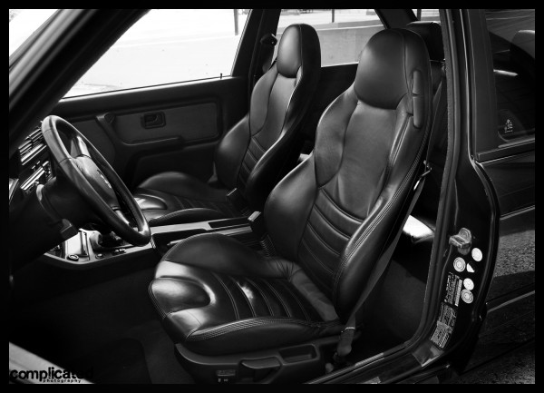

            I stubbled upon a pair of Z3M (2000) seats and I am having a hard time finding good information about them in an e30. I show a post from Bimmer forms and the guy said that with an adapter they are a direct swap.
            Do you guys have any more information on this before I grab the seats?
            The upholstery on mine is ruined basically and I'd like to swap if possible. Seats are in great condition I'd like to buy and the price is really cheap honestly (200).
            Any information or direction on this would be great, thanks.
            • Kershaw
              • 11822
              #111
              With the right adapter, anything is a direct swap. Lol. Meaningless to say unless you can make or buy the right adapter.
              people have definitely done it before
              You probably need to start with CAD (cardboard assisted design) to mock it up. If you have a welder, it shouldn't be that hard. Definitely not a "direct swap" though.
                thanks for the information. that e30 thread i hadn't seen yet. so the z3m seats are completely different from the z3 seats.
                here are the seats in question. I'm gonna go grab them today.
