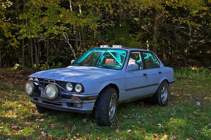

    I just wrapped up the cage for my offroad e30 and thought i'd share a few pics. A buddy posted it to the facetube page the other day, so i'm sure some of you have seen it.
    And yes, I do use it.

        What suspension mods have you done?

          It's all home brew stuff. The front is e46 control arms with sleeved strut tubes (1.5" longer) and vert springs. The front ball joints are pretty much maxed out at full droop. The rear is a modified subframe with diff mount to match, keeping the cv's flat at ride height as well as the trailing arms.
          I'm cycling about 7 inches of travel up front and a bit over 8 in the rear. The rear will tuck the white letters without flinching.
          Keep in mind there was a lot of trimming to keep everything clear of the 30's
