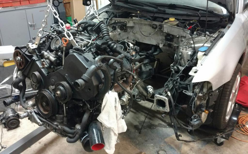

                Turbos are on! Had to do a little work getting the drivers side to fit. They are tight, that's for sure.
                Sorry for potato photos, I broke my phone last night while working and my camera battery was dead.
                Still have to do some tweaking on one of the factory coolant lines, and find some m8x1.25-15mm bolts for the oil return. Regardless, connecting the lines on these is much more user friendly than the factory setup. Also need to get creative to give the lines as much clearance from the manifold as possible. Luckily, these manifolds are double walled so it's not near as bad as if they were standard pipe.
                Intercooler and clutch will hopefully show up soon! I'm ready to drive this thing again.

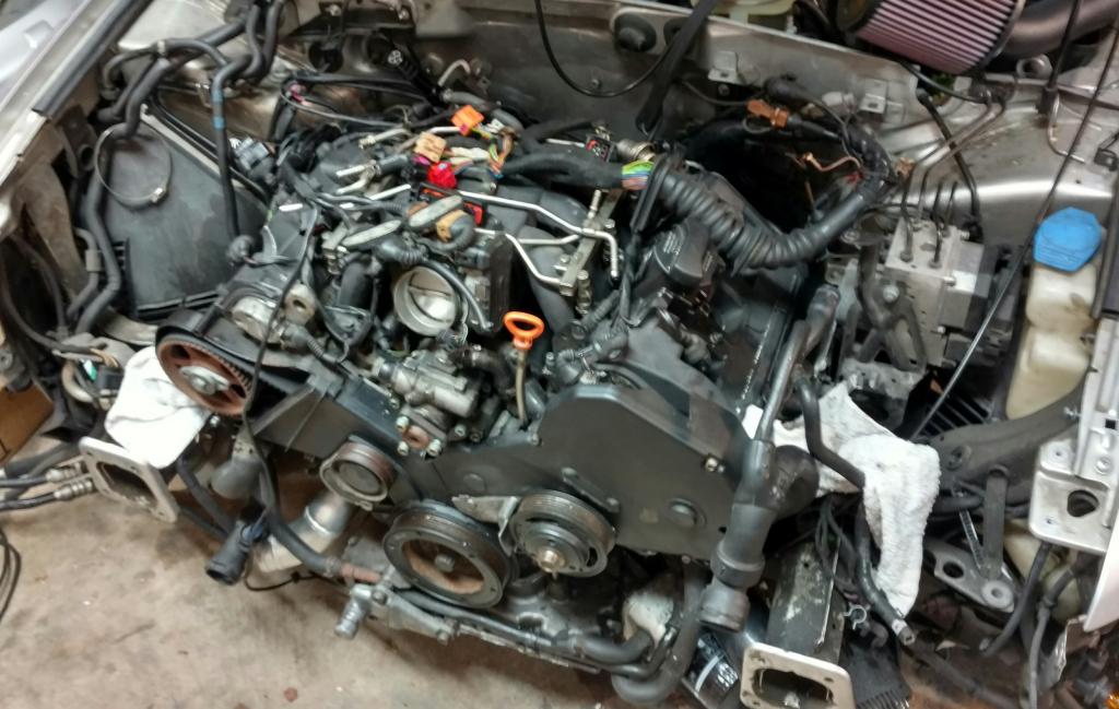

                          Through all this, I forgot a major item! Air filtration!
                          Since I'm running a blow through maf, I wasn't sure how I'd tackle this. Installed the inlets tonight and took some very rough measurements (hard to be sure with the engine out of the car), and some even more rough estimates of what CFM this engine will be pulling. The formula I used does not take into account turbo variations, only boost pressure, so I'm not sure how accurate it is...
                          Using a guide I found online, I'm looking at around 1230CFM if I ever crank it up to 36psi.
                          Then I realized how undersized the filters I thought I'd run would be.... The 3.5x4" filters I was looking at will only flow 660cfm (between the two of them).
                          Kept searching the k&n website. Ended up deciding on a set of 5.5x6" filters. Together they should flow 1243CFM. Now, the 1230 I calculated would be an absolute kill mode, so I should hopefully have some head room there.
                          Also makes me realize I had too small of a filter on there before. According to the formula I found, my old setup was pulling around 960CFM, while the filter I was running is only flowing around 500cfm.
                          No wonder guys running big numbers don't even bother with a filter, just ends up being a restriction.
                          With this new info, I'm kind of glad I went with a blow through and individual inlets for each turbo. Learned a bit tonight.
                          Kicker, is I punched in the P/N for the filters I settled on, which are a $55 filter, and found them on Amazon for $16 each with free shipping!
                          Hopefully it wasn't a price error, and they are just clearing stock. Everyone else had it listed $50+. Fingers crossed they actually ship.
                          Anywho, here's some photos of where I stand now, and a rough idea how I'm thinking of mounting the air filters. I will have to wait until the filters come in but I think it I cut them around where my fingers are, I can make this work and have the filters sit right above the valve covers without hitting the hood.
