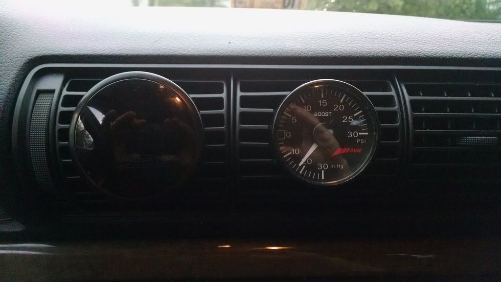

        Boost gauge installed.

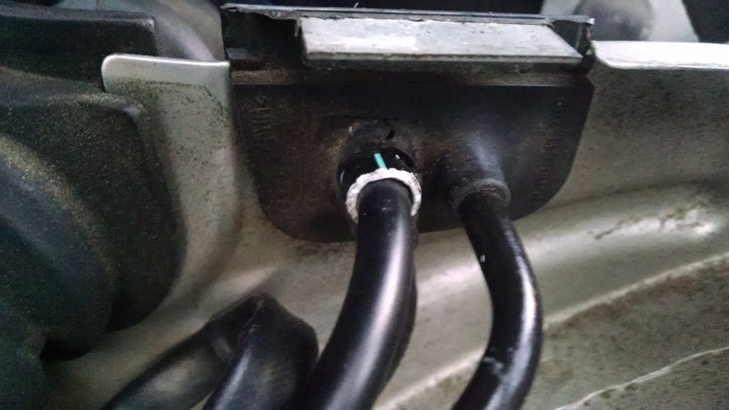

        Hose was getting crushed at running temperature, so I rigged up a sleeve out of a pen. Ghetto, I know.

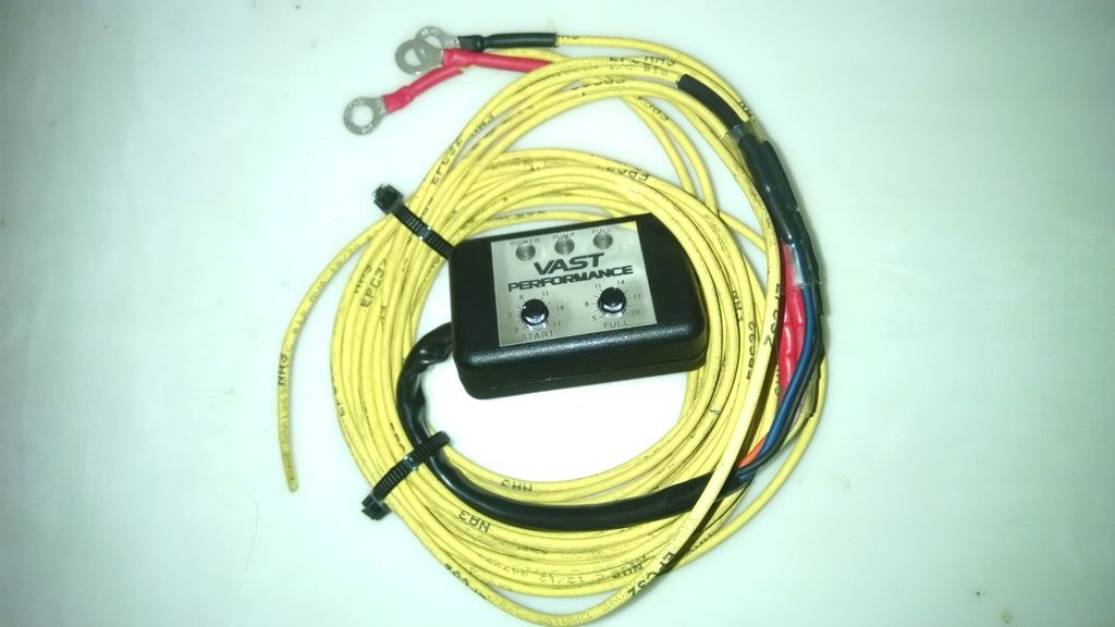

        Methanol controller pre-wired and ready for install.
        Just ordered all new fittings, nozzles, and hose for the methanol kit. Oh yes.

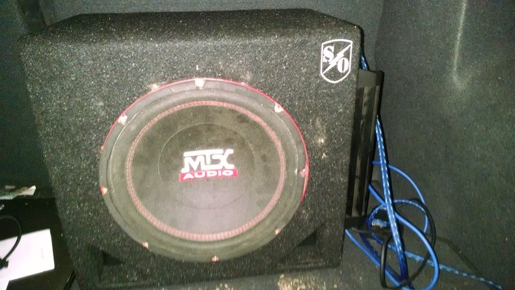

          I got sick of listening to nothing but conservative talk radio for my 2.5 hour round trip commute each day.....
          Also installed this guy (Yes I will clean up the wiring, I also need to find a quick release way to secure it.)
          Had the sub laying around for years. I originally tried my Comp 10 but the box is way to small for it and the thing sounded like shit. The MTX sub is designed for a smaller enclosure and sounds 10X better. Serves me right for not considering the specs on my Subwoofer when ordering a box.

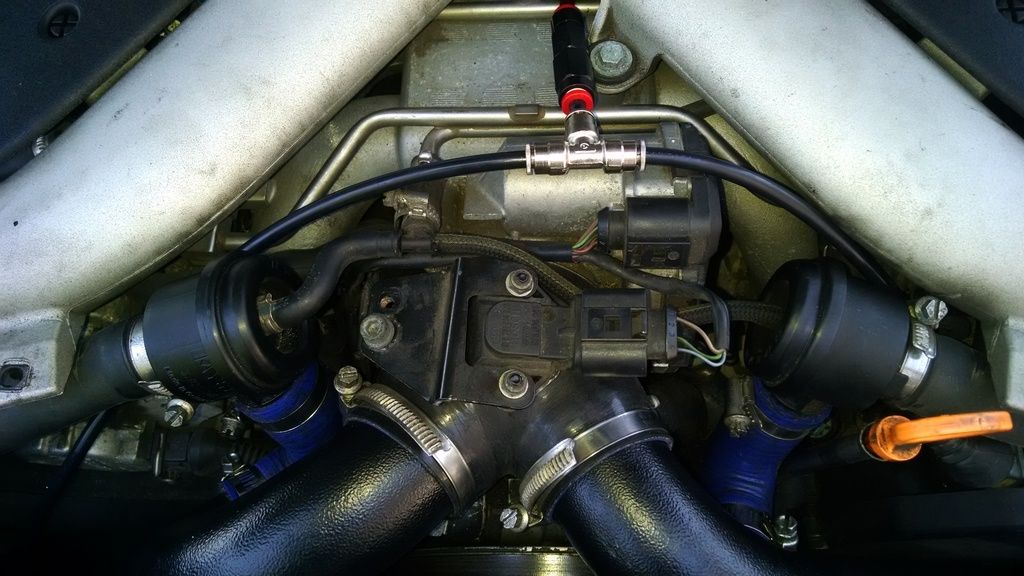

            Finished the methanol install last night. This car has become quite the sleeper. Still running stock exhaust but it has an awesome note at WOT.
            I haven't gotten a chance to bump timing but already noticed a significant improvement in the top end, most likely because I'm still on stock intercoolers so I'm getting a ton of benefit from the water.

              ETA: don't mind the hacked methanol pump. I cracked the housing when replacing the fitting on the output. It was seeping during use, so I slabbed some jb water weld on there. I've already ordered a replacement head so that will be properly repaired by the end of the week.

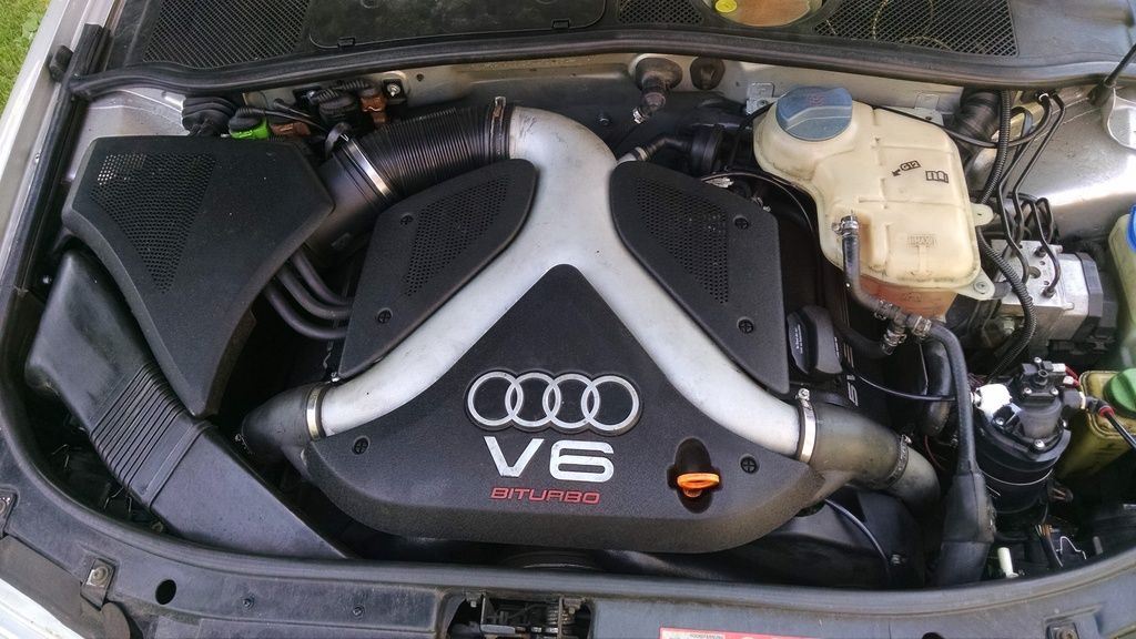

              Wouldn't know there's an 88mm maf in there. As stock looking as it can be and I don't plan to change that. I am seriously considering sticking with the stock cat back and putting electric or boost actuated cutouts on the midpipes.
              Well, it looks stock under the hood... I was tempted to hide the controller but decided I liked the idea of it being in my line of sight. It will tell me if there is an issue, so best not to hide it.
              My AFR is dipping into mid 10s, so I just did a quick tune edit. Added 5* from 4k and up, and pulled a little fuel at max load. Got it back to the high 10s and the car already feels amazing. I need to do some more work on the tune, I'd like to get it around 11.5, but for now it almost feels like going from stock to stage 1 all over again. Can't wait to get a fmic and these big baby snails installed. For now though, its sufficient. I might just keep the k03s on until they die.
