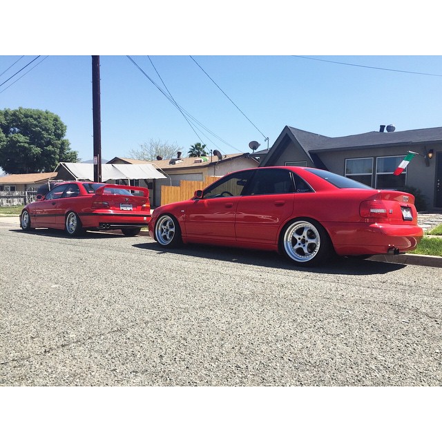

                    Here's my money pit. 195k with original engine and turbo's, 2nd owner. Currently under the knife at my shop, getting a fully rebuilt tranny with updated shift collar and full carbon syncro's. As well as some new snails :giggle:

                      ^ Photos like that keep making me rethink my position on sticking with Avus wheels.
                      Great looking car.
