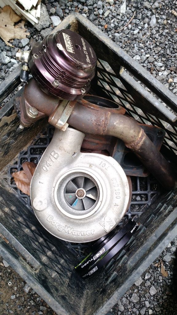

Picked up turbo and wastegate today.
And... This is already getting out of hand. He offered it up, and I said what the hell.

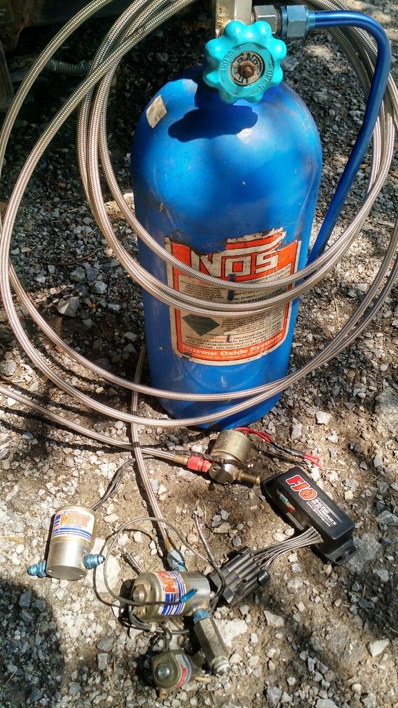

So, now I'm going to shoot for 700awhp on the juice. The nitrous will be brought into the occasion after I've got everything dialed in on e85.Leave a comment:
Lol, at the rate I'm going we'll be at 700 wheel before long. I'm excited to go single though, bigger power will just be a turbo swap away.
The new engine will get rods, new rings, hone, bearings, and a girdle. Blocks seen to crack around the 600wtq mark. The girdles haven't really been proven, but then again I haven't found any blocks cracking with one on.
Anywho, 600whp should be fun for a while. I'd love to pull off some 13xmph traps.Leave a comment:
So I've worked out a deal to pick up a BF (late, stronger block), 2.8 cams, and 2.8 exhaust manifolds.
I've also worked a trade with a close friend for a freshly clipped/balanced S256, 38mm wastegate, and random odds/ends like feed/return lines and possibly a big BOV.
Total cost at this point will be +$800. Turbo and parts I will be trading another toy for, and the block/cams/manifolds is a trade for my current turbos/in/maf + $800 from him.
I've already got a decent Mig welder, so I'm going to buy a TIG welder and make this shit happen.
Shooting for 500-550 on 93+meth, and 600+ on e85. I'll be wringing the s256 for all it's worth.
