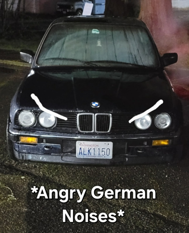

                                #165
                                Not much of an update, But something. going to wider tire and fixing the brakes made it possible to drive the Dumpster Fire all the time, even with crap weather. It's still sketchy in the wet, but not like it was. I took it to work the other day, Wow, it does not like the cold! LOL This is when I came out at 0645 and started it to let it warm up before heading home, It defiantly was not happy.
