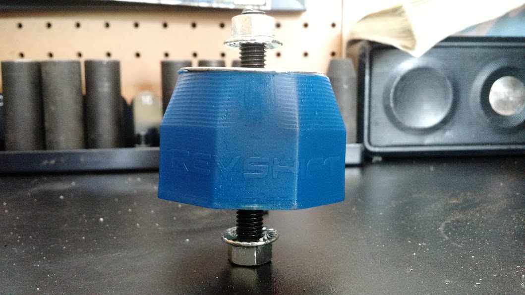

                      Still not much progress but I replaced the motor mounts and installed an Eibach front Anti-Roll Bar.
