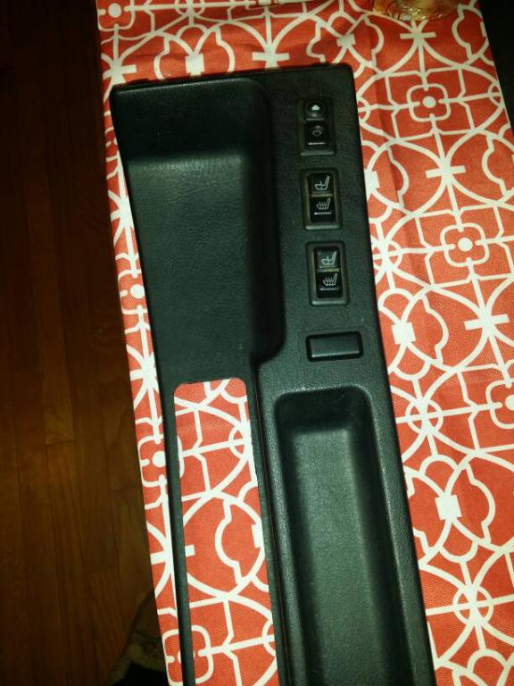

                    Here is the switch setup.
                    Window switch at the top is full car up and down. Kill switch at the bottom is the auto level on/off. I have a 7 switch controller as well but i plan on these being the main 2.
