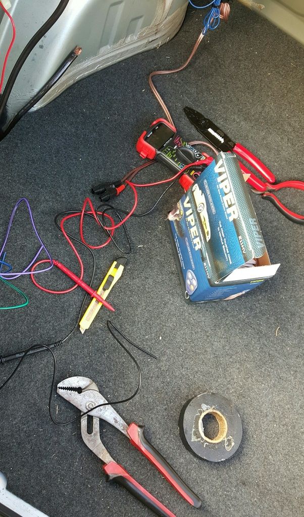

What could not wait for another day though was the keyless entry that the mailman delivered today. For the keyless I am using a viper 211hv unit that comes with a lot of features but I only cared for the lock and unlock.... anyways, It was super easy to install the keyless using the harness in the trunk and it works great.
Trunk Wire used
Green/Violet (unlock - harness)
Green/Black (lock - harness)
Brown (ground -harness)
Red (12v constant - antenna harness)
Viper 211hv wires used
Blue/Black (unlock #30 common output)
Green/Black (lock #30 common output)
Violet (ground - unlock #87 normally open input)
Violet/Black (ground - lock #87 normally open input)
Black (ground)
Red (12v constant)
Picture of me starting to get the wires hooked up but I did not get a picture of everything all buttoned up because it started to rain so I rushed to finish it up.
