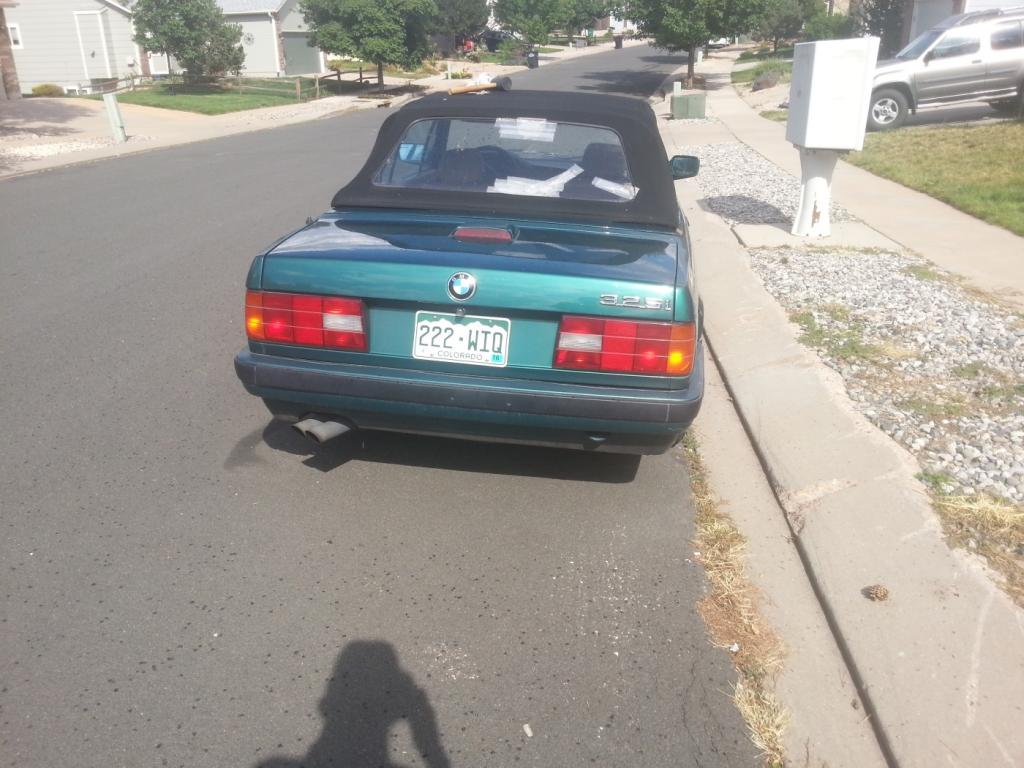

    Scooped up this Laguna Green on beige vert for around 1500. 5spd, 134,870 miles and everything works for the most part. Heated seats too! Electric top doesn't work anymore, so I have to figure out how to get it down manually. Newer clutch, just had a valve adjustment too. I even have the window sticker from the dealer the original owner got it from in the 90's. It's crazy that a car you can get for dirt cheap, someone paid $36,350 for back then. :o
    The plastic window is trashed, but since it's a 92, I've got a zip in window, so I'll just get one of those eMiata windows and call it good. ;D

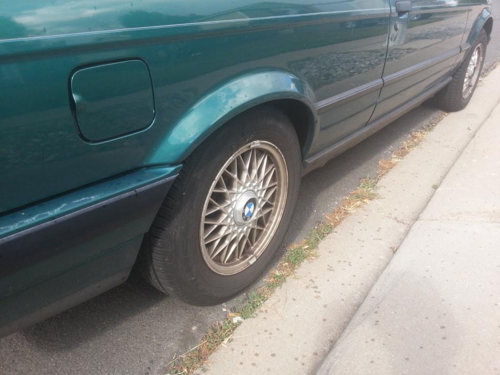

    It has the BBS alloys that I wanted on the last vert I had, so that's a plus! Some curb rash, but that's to be expected. Has all the center caps, so that's good too. New tires, brake rotors, pads and calipers. Drives straight and there's no squeaks to be heard. Just the typical vert noises. Top components rattling and whatnot that I'm used to.

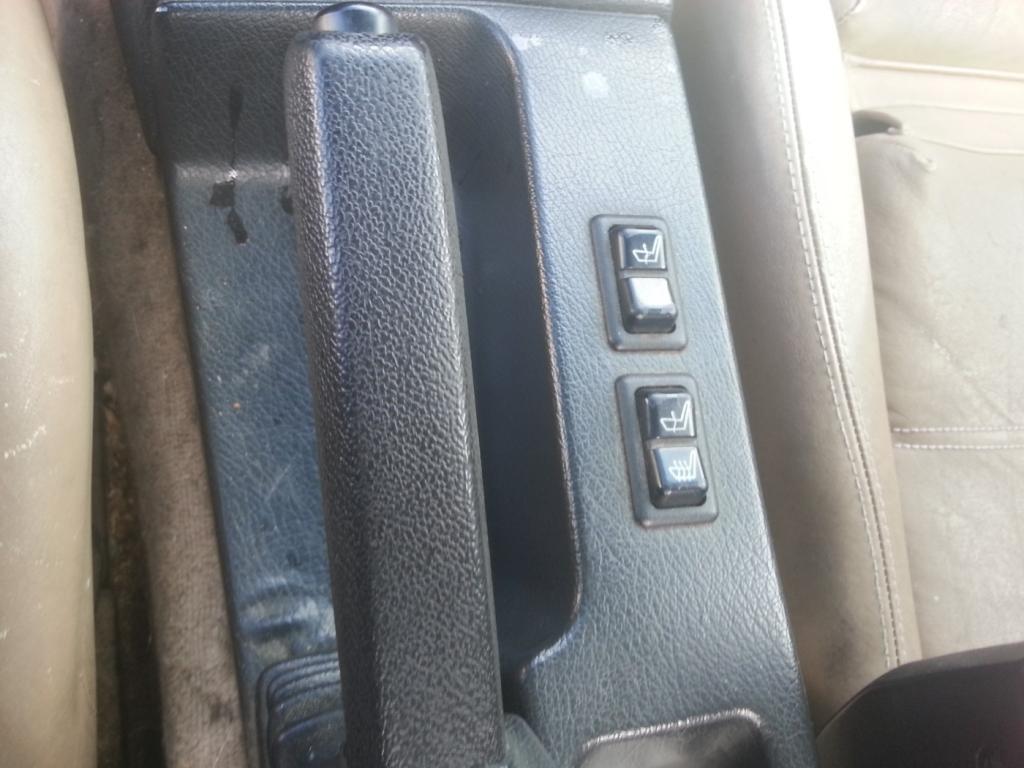

    Interior definitely needs work, but I really don't wanna replace the front seats because they're heated, and that's nice in Colorado winters. Our old Audi A6 had heated seats and those were a godsend. The rear seats are trash, so I'm gonna see about restitching and getting some covers. other than that, the dash has fewer cracks than the last vert, so that's nice, I suppose. A/C works too.
