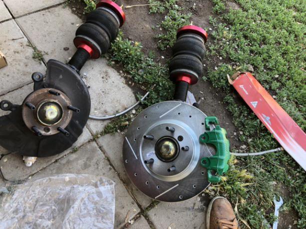

      So....pfffft I’ve made some progress, but not enough. Here’s where we are. Waiting on parts still.

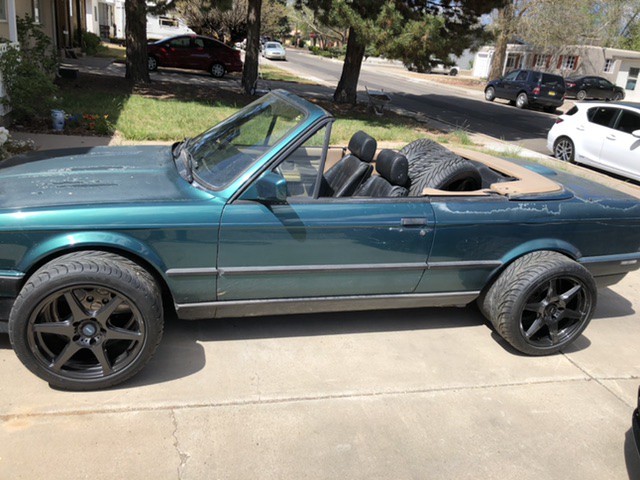

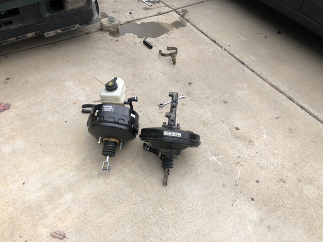

          Here’s how it’s looking.

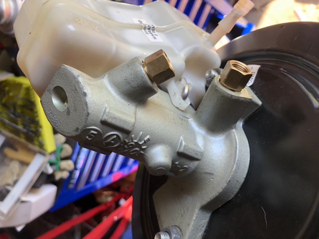

          I used an e90 euro brake booster and the adapters. I used an e90 clevis pin and clip and tossed the spring. Bolts in perfectly.
          • onlyindef
            • Dec 2017
            • 42

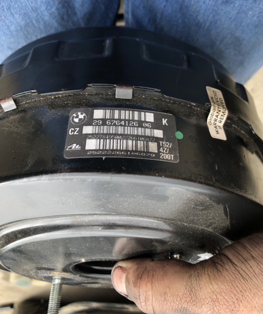

            #95
            Here’s how the brake booster turned out. I flipped the master cylinder on the booster so the vacuum line popped right in. I used the e90 clevis pin and tossed the spring. Pictures show you all the extra clearance. Just had to bend the lines a little. Super easy swap. Now I just have to hunt down an engine.
            • onlyindef
              • Dec 2017
              • 42
              #96

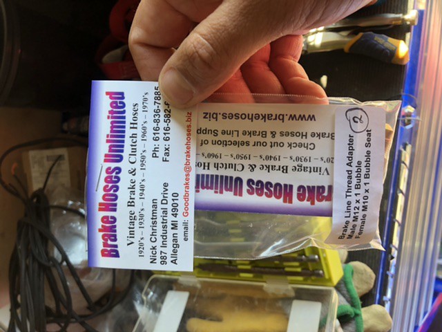

              I used an e90 euro booster, and these adapters. Here’s pics of the part number, and it compared to the e30 booster. I leave no mysteries.
