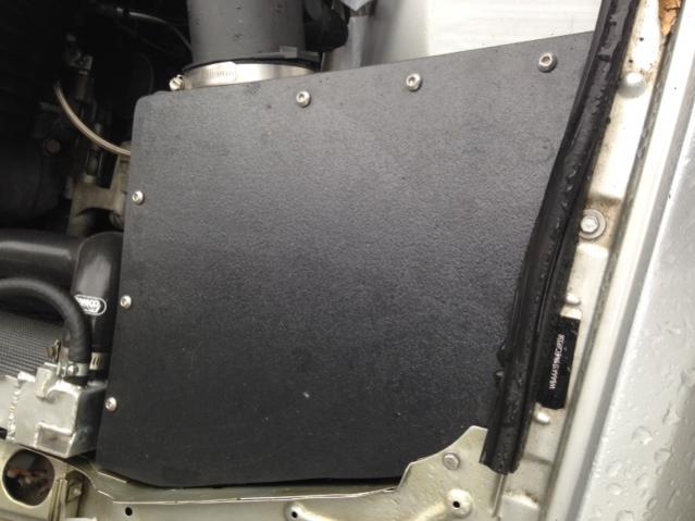

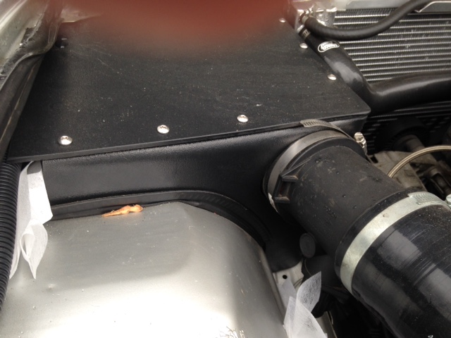

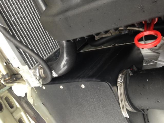

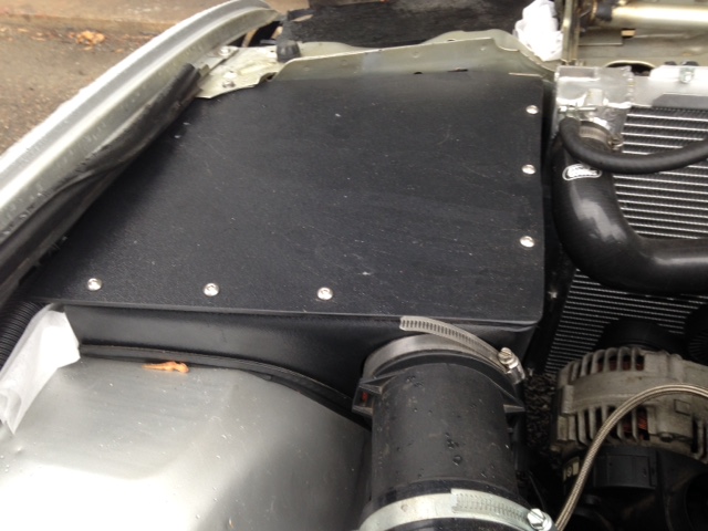

              Thanks for this info. That's definitely within my budget! I'd like to give it a try. Do you have any up-close pictures of the box by chance? I'm guessing you used 1/8" ABS and heated it with a heat gun? Did you use nutserts or something to allow the lid to be screwed down? I'm guessing that there are others with 24v swaps who would enjoy an instructional write-up with templates and such. No pressure! :)

                  Unfortunately, no I don't. Not from when I built it anyway. I can take some tomorrow though. Cars in storage for the winter so its a little tricky to get to at the moment.

                        Sorry for the delay, got held up on time. I apologize for the quality in advance. But as the pictures show it is two pieces of ABS plastic (one top cover bolted to a single heat folded piece) with some extra trunk lining I had as a gasket and a big hole cut in the front of it for my 3.5" MAF.
