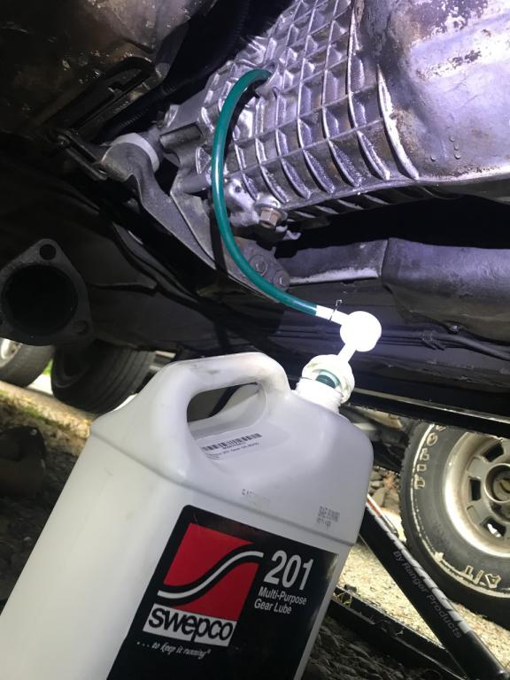

I have an E 30.
  • Nader393
    replied
    Now that it's raining, work is going to slow down. Took refuge under the car, and changed the new-to-me transmission's oil as part of my effort to baseline it. Don't know what was gear oil was in it, but it probably wasn't any better than Swepco 201. German cars love this pretty blue/green stuff. Gonna put it in the diff, too.

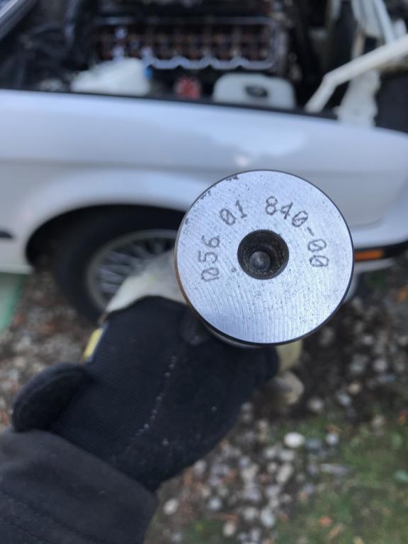

    So I decided to install a known standard as a baseline. Schrick 284.

    Tiring of testing "mystery cams" from these two heads I've collected. I'm not sure what's what, nor what's good. Why am I bothering over this, and subjecting my family to this miserable folly? Two oily e30 heads in the den? What's wrong with me? Kids, don't be like me.
