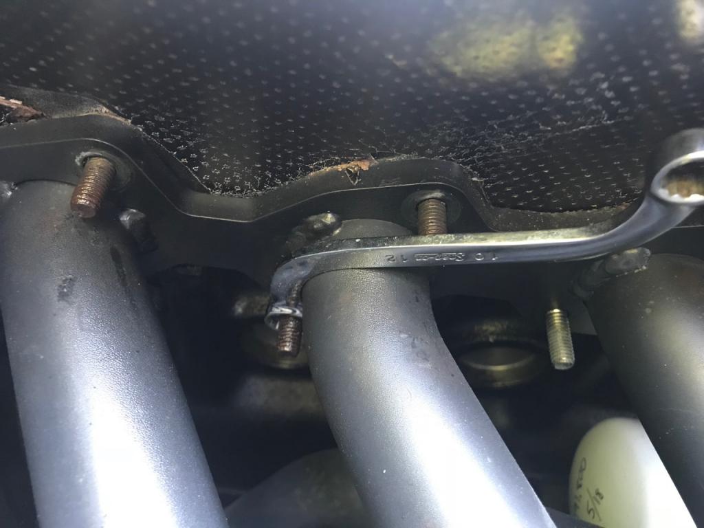

    Now I need to go deeper, and see what pistons are in there. Need to detach the headers before pulling the head. Luckily, I have Gerhard wrenches. They are the only thing that will reach around the tubes to undo the nuts.

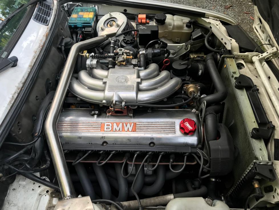

    Finally got around to tearing into the engine in my car, to see what it actually has. It was advertised to me, and the previous owner(s) as a Metric Mechanics 2.9L engine. But despite upgrading it myself with over a $1K of bolt-on upgrades (IE long tube headers, and Miller MAF and chip), I only got stock horsepower on the chassis dyno. So lets's see...
    First, address the pretty engine:

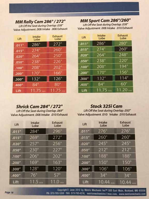

    Found this:
