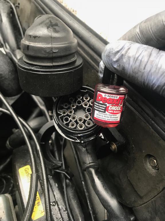

    Speaking of fancy fluids, I dabbed some of this DeOxit D100 on the electrical contacts of everything in the engine bay, including all the connectors on the new harness and the ECU. This stuff is used mainly by audiophiles and finicky musicians. How OCD are you?
