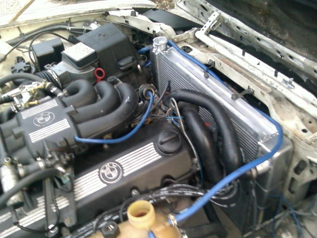

    my eta after cleanup and paint while replacing head gasket, and radiator

          dranttna, nice blue hoses.

                  i know, im ashamed of them... but needed hoses and those were just laying around not being used, for abvious reasons

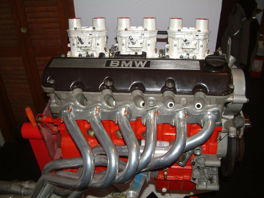

                    well here's mine
                    This isn't in my car as of now but I figured I'd share it anyway. I'm still waiting to pick a nice clutch and light weight flywheel before it goes in. Also gonna have to do some electrical work as well but here it is. It's a 2.7 block bored to 3.0ltrs, Metric mechanic custom pistons, 85 524td crank, 325I rods, ported and polished 325I head with schrick 304 cam and valve springs, tripple weber 40IDF downdraft carbs, mangaletsi (prob spelled wrong) intake manifold ported n polished, euro 323 side mount distributor and us spec distributor delete timing cover, BAV auto headers and plug wires. I'm sure there's more but I forget the rest LOL.

                      wawaweewa ^
                      i could drool over these pics all day
                      i'm rebuilding my head and gettin ready for the 2.7i... then it will be purdy.

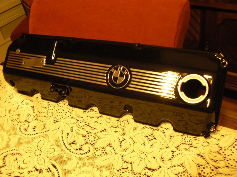

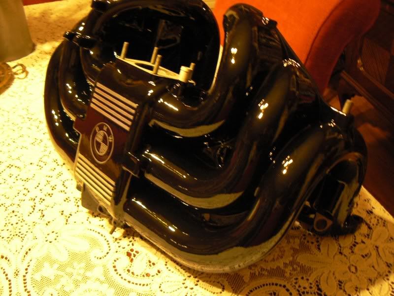

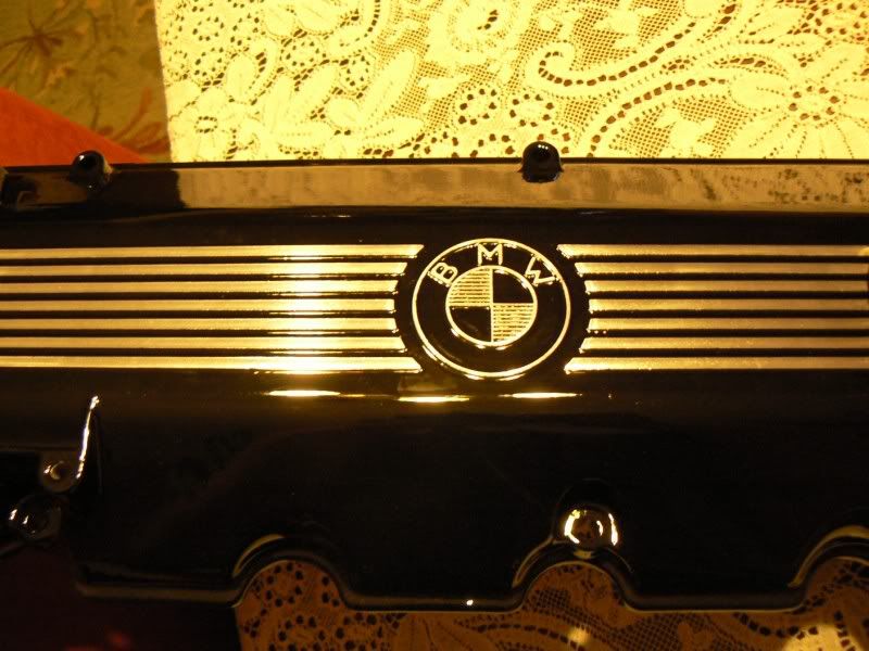

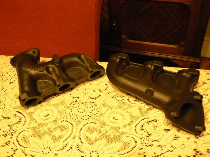

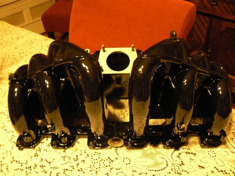

                        These will be going in my engine bay here in another few weeks.
                        So beautiful.
                              So beautiful.
                              thats sexy, hope the rest of your bay looks good to match the new bling. :p
