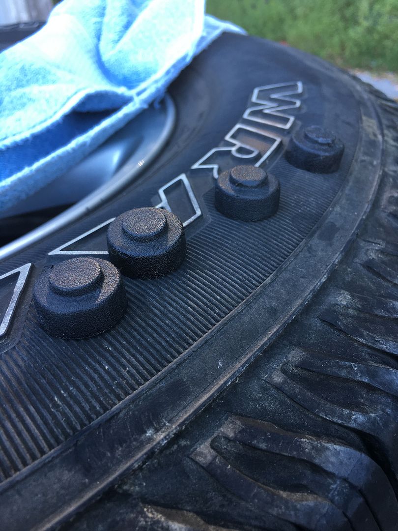

              This fucking car. Today was suppose to be simple. Oil change, oil cooler housing/filter housing o ring, tire balance, and check everything for tightness.. Well the checking part went south. Like literally.
              A couple weeks ago I left an e30 meet and hit 2 huge potholes. And noticed a funny feel in car in certain turns. So as I was tapping the tie rod ends with my snap on mallet. The driver outer shoots out of the knuckle/strut housing and strips all the threads on the tie rod and nut.
              Go to Home Depot for a m10x1 nut and found one and bought 3. Tried my best to get at least 1 but to start but absolutely wouldn't.
              So I have 2 brand new nuts and 1 effed one.
              It will be pushed outside on some car dollies till my spacers arrive for the E36 swap. It never ends with this here car.

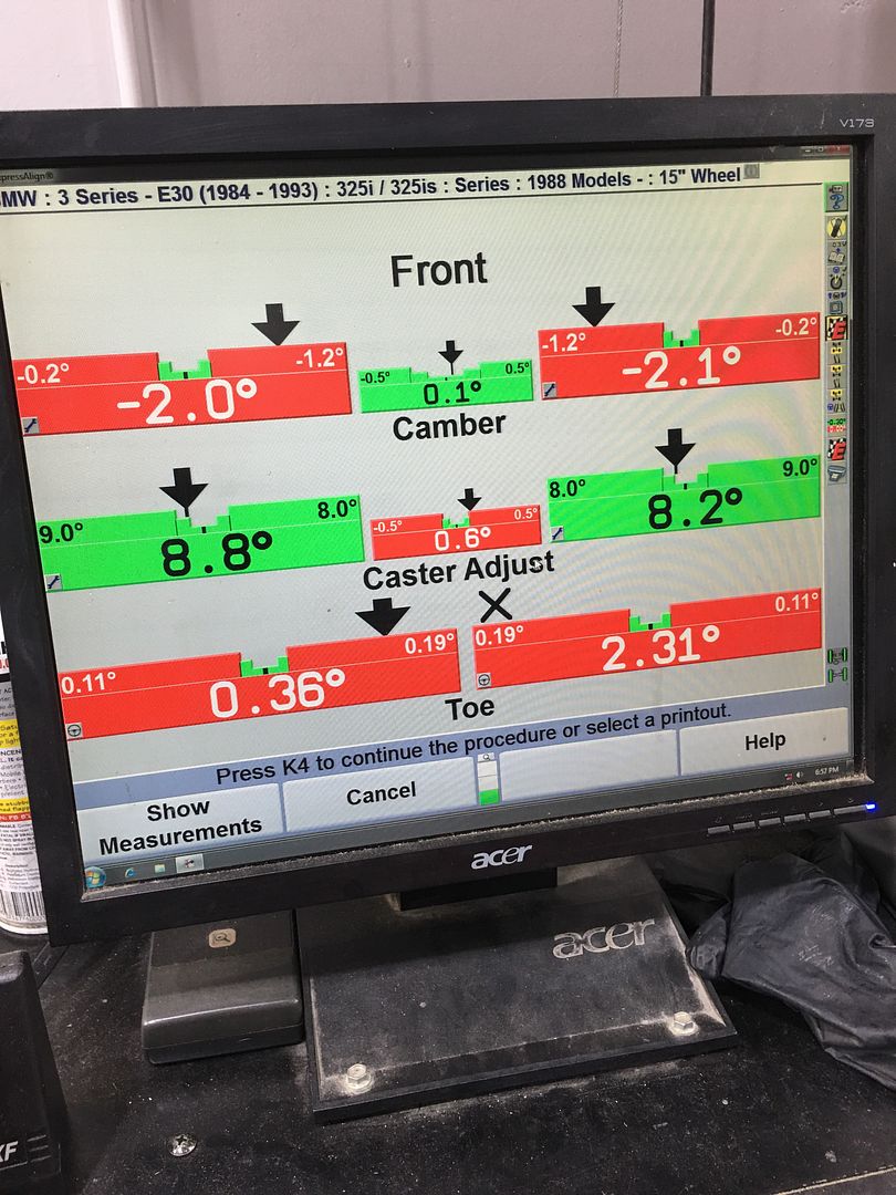

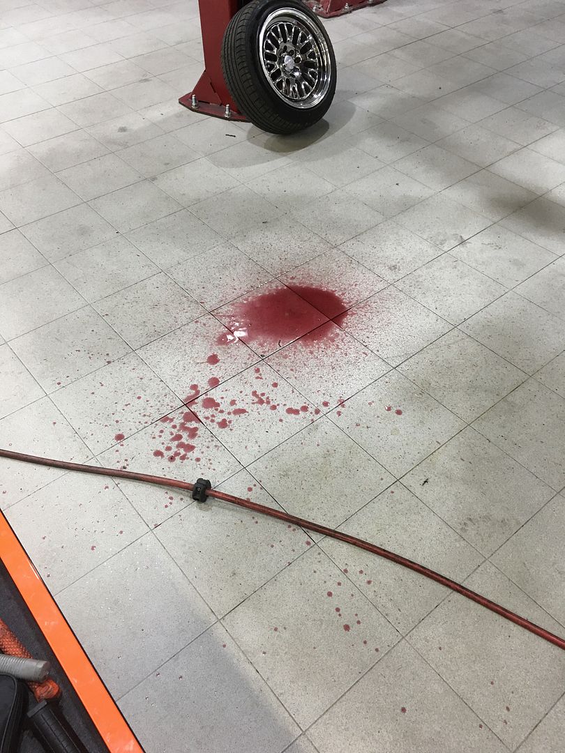

                      #100
                      Nice update!

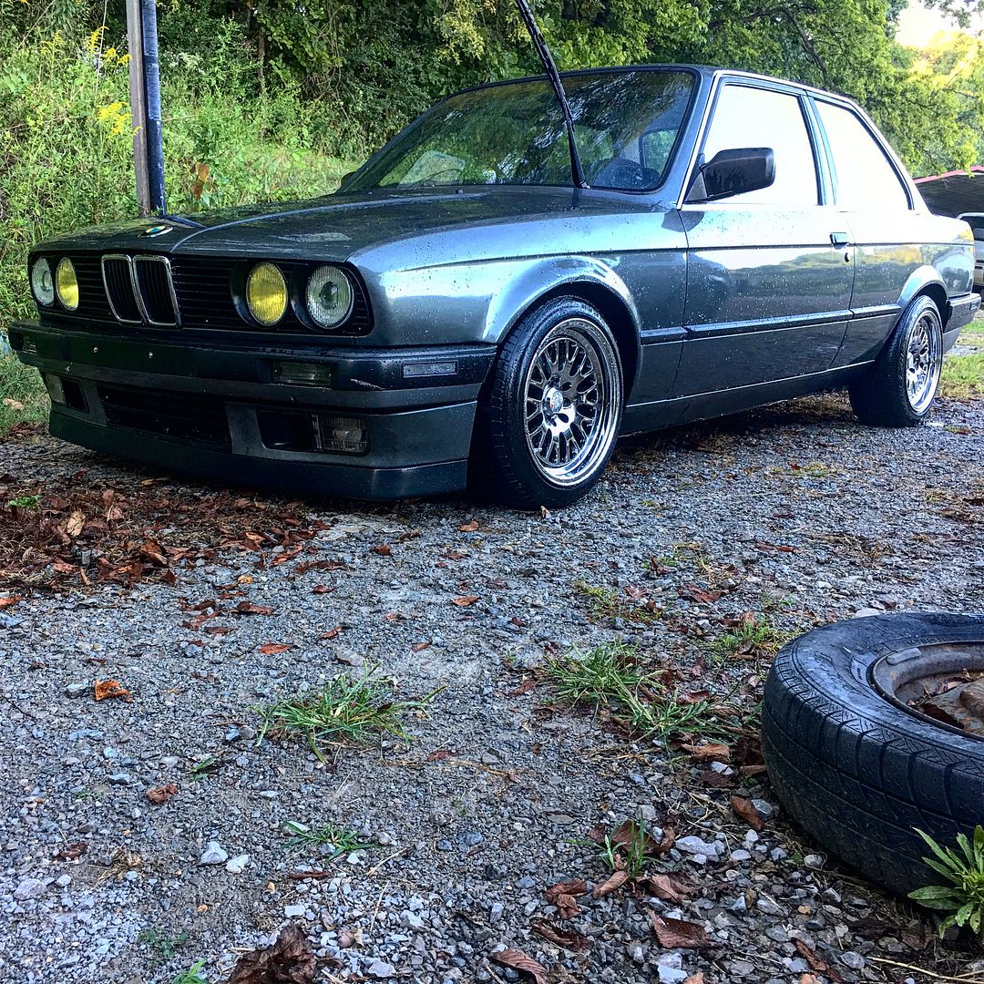

                      Agent and I installed the e36 rack. A lot more simple then I thought It was gonna be.
                      On the old rack it was holding around half a quart in each boot. Here's a picture of the first boot removed..
                      That moment you align your car. And agent says "the passenger is barely off"
                      I couldn't help but laugh when I saw this.
                      I think maybe the joints in the coupler I got from a member on here are bad. On my rocky driveway it makes a little noise and has a slight vibration in the wheel when I barely turn it. Other then that this car drives and steers tight and fast now. Hopefully I can enjoy driving it again without any worry for a little while.

                        #101
                        yuck! that caster is nasty. Unstable at high speed?

                          #102
                          Rides good actually. 75-80.. We think PO put the offset lca bushings on the wrong side. But wasn't sure so we left it. but from what the picture looks like, it's suppose to be around 8.5 degrees of caster by spec. It's barely off on each side.

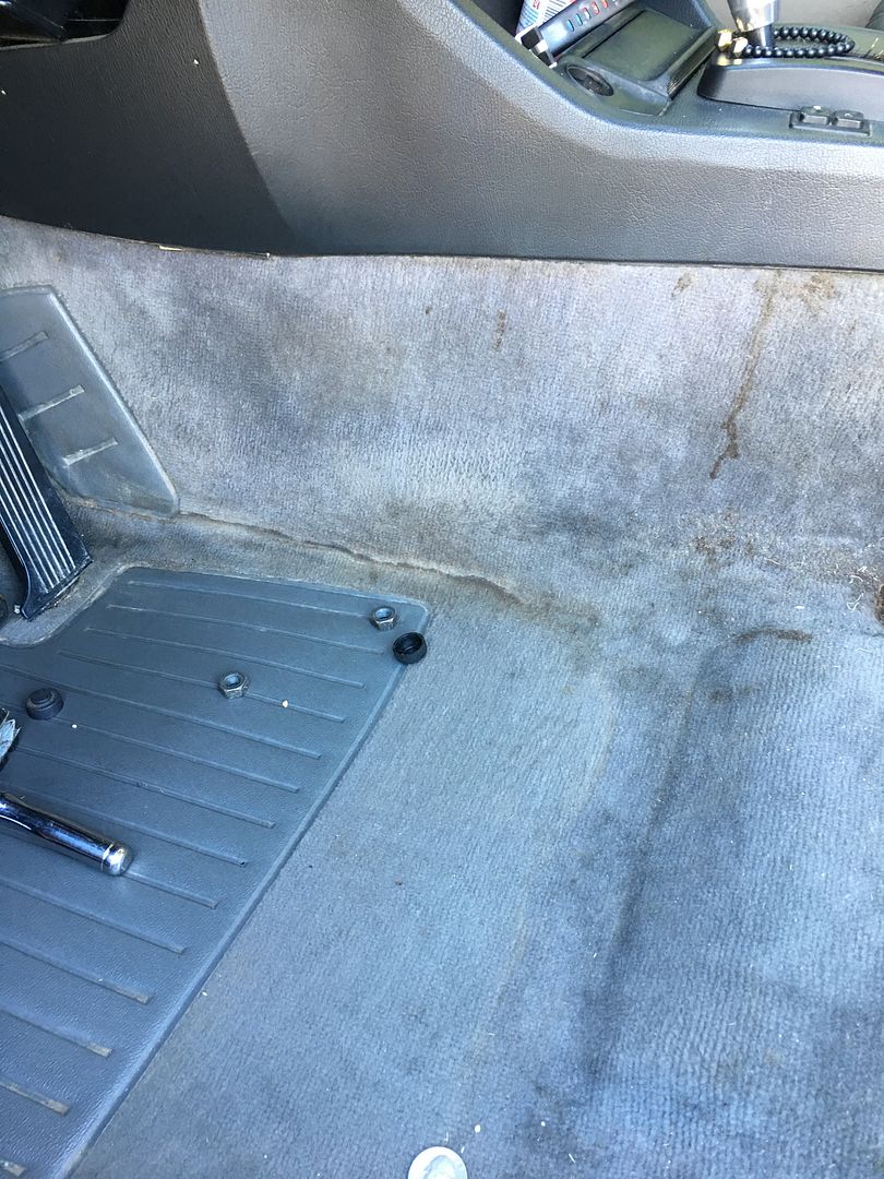

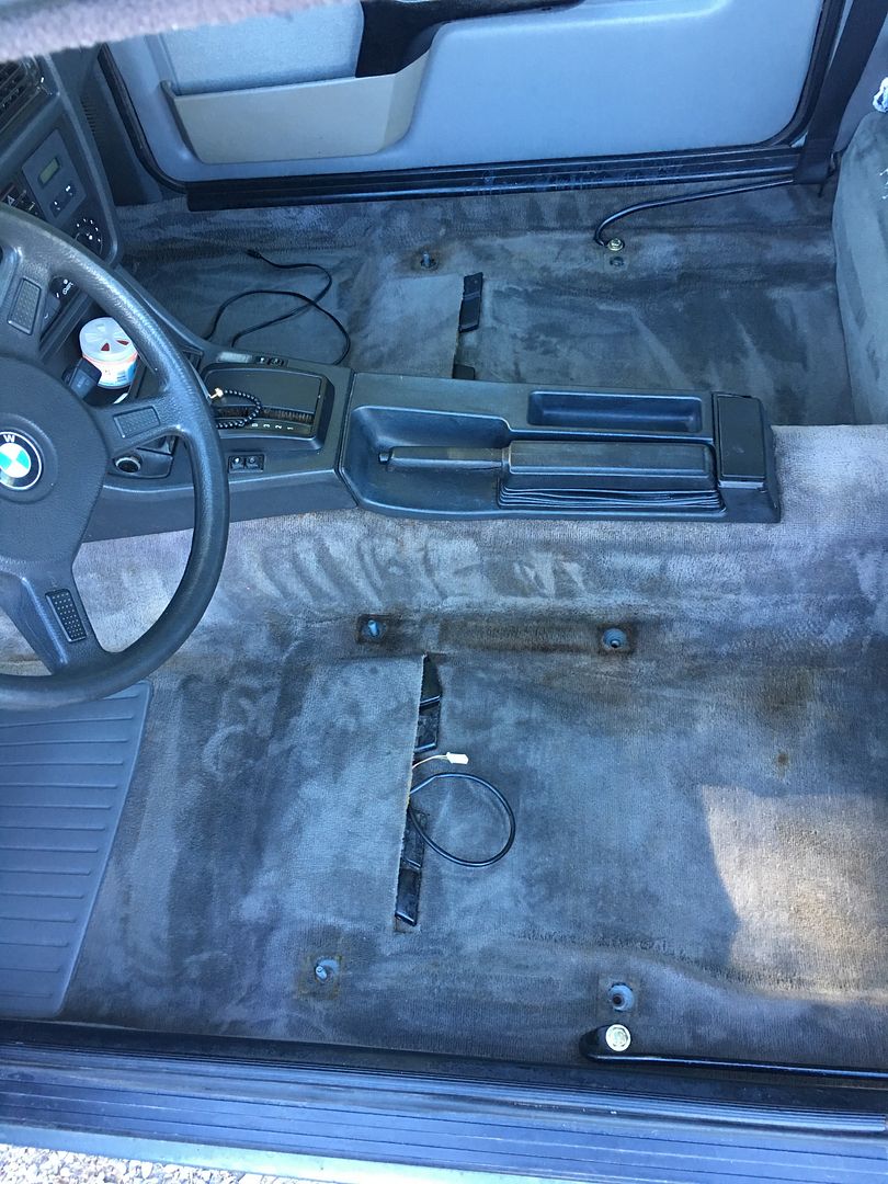

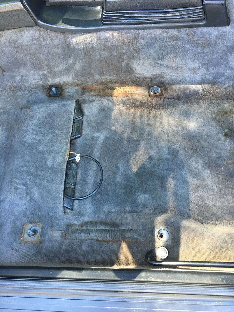

                            So I can't leave anything alone. It looked to me as if the PO had left the windows down once or twice in the cars life and never tried to clean the water or even spilled something. I'm a clean freak and it was nice outside yesterday. So the seats got pulled.
                            Here's what it looked like before a vacuum was used.
                            There was a water spot in drivers floor board. Here's a before picture of it.
                            After about an hour and a half, both sides were clean. Used some stain remover for clothes, original krud kutter, a tooth brush, dish brush, and a bucket of soapy water with dawn soap. Then used a vacuum to suck up as much water from the carpet as possible. Did this about 3-4 times. But of course it needed to air dry, so I'll take a picture today when I get home from work. So here's a picture of it kinda damp.
                            I even cleaned seats tracks and the little nut covers.

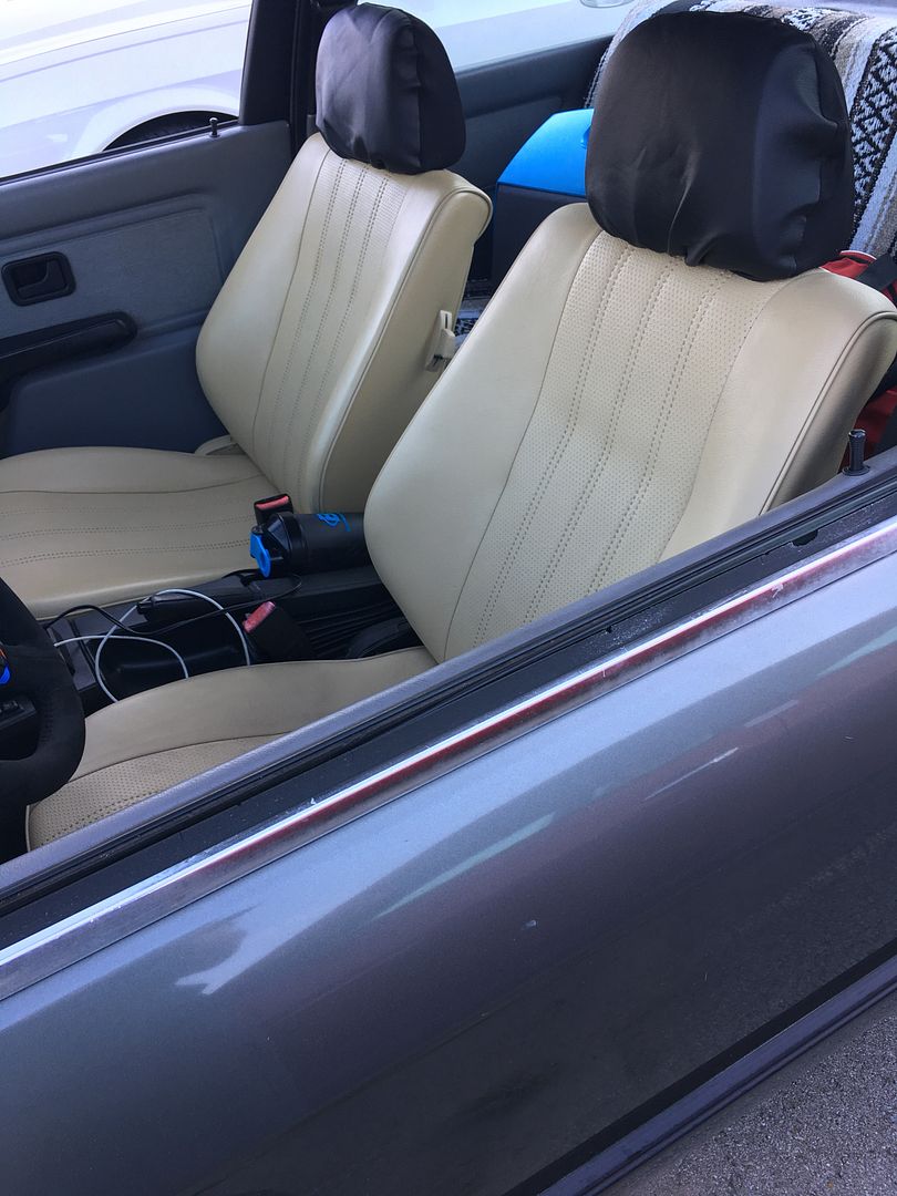

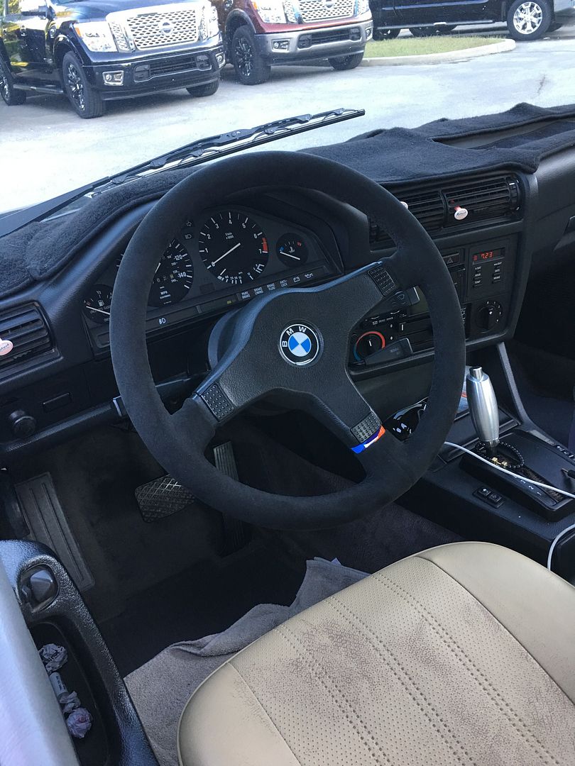

                              #104
                              Ah snap. Another stupid update..
                              Steering wheel is in, along with a 6 button obc.

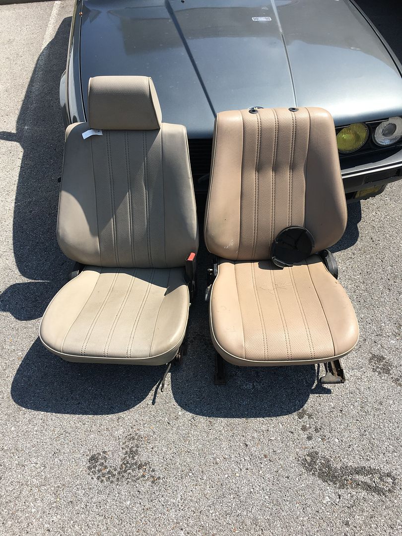

                              New to me seats, that I dyed. But didn't let the drivers dry long enough so it has peeled in spots. They were both passenger seats, that I switched a frame and all the works over to the drivers side seat. It had a broke mount for the back portion. Now it's all fixed and ready to be used.
                              Before:
                              After paint and fixing 1 seat, don't mind the ugly headrests.
                              Also got a eBay lip put on. I dig it a lot. Now the rear needs about 1 inch lower.
                              Next on the to buy list- camber plates for front, order crush wagers for power steering banjo bolts and the out line for the auto trans, silicone hoses for the cooling system and fix the tiny coolant leak, along with the valve cover that is getting worse..

                                Been messing with the suspension. Put IE rear springs in with bullies. Rides good but kinda stiff and having a small thunk over bumps. I thinks it's because of the poly diff bushing and you can here everything.
                                The front got camber plates and billstiens also. Very unhappy cause it raised the car up an inch or so. But ride quality is great. When I took the kyb front struts out of the housings. They were pouring fluid out from where I lowered it so much and blew the hell out of them. Whoops!
