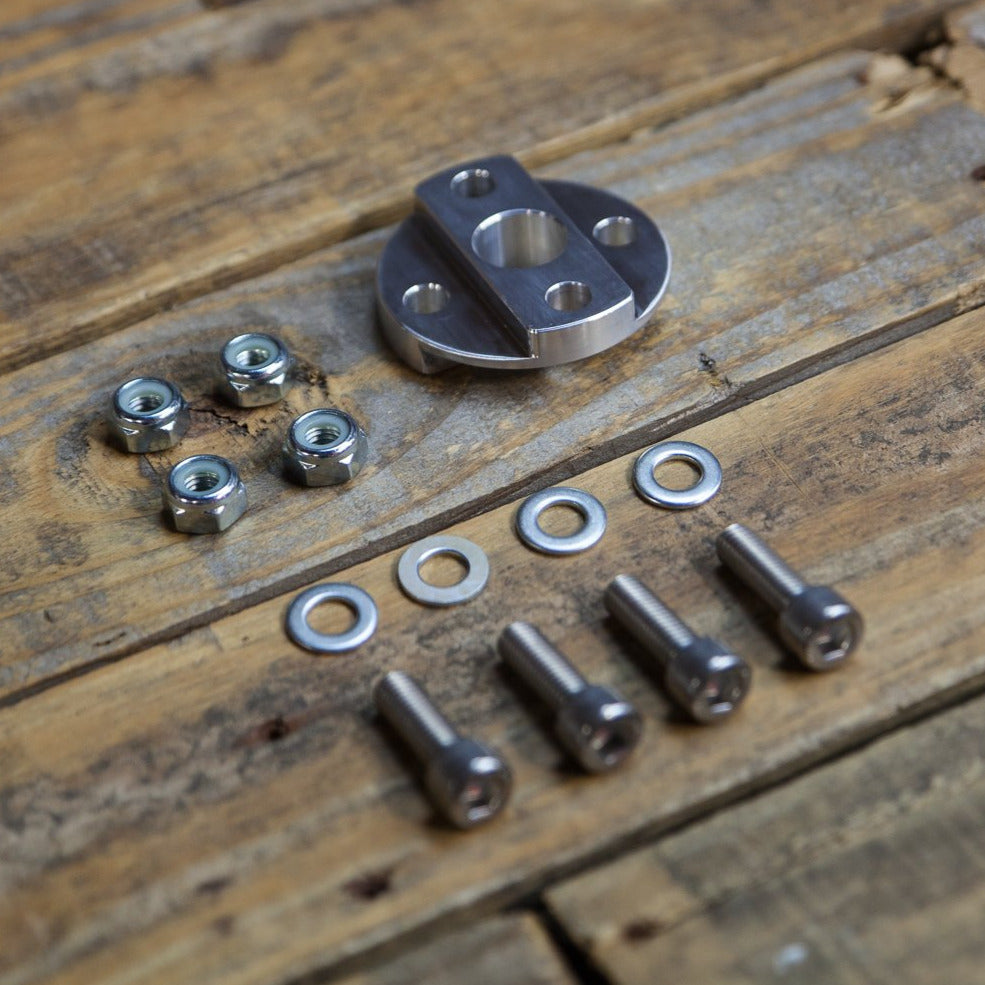

                            So an update about the steering column guibo. After looking online, there are two different types. One regular and one for airbag cars/steering column.
                            Most (delrin) steering couplers I find are for the regular steering column E30's, where the guibo is located inside of the engine bay. (However, with removing my original steering coupler, I think one of these might also fit. as the thickness of the coupler isn't very important which I later found out).
                            So before I knew about this information, I decided to order a "universal" polyurethane coupler that fit's a number of older BMWs (2002, E9, E28, E30....)
                            This week it arrived in the mail and I fitted it this weekend as next weekend I'll be participating in a drive/meet.
                            The new poly coupler it quite a bit thicker, I was hoping to be able to reuse the original studs that are pressed in the shaft and aluminium mount but had to press these out with the bench vise
                            It was a tight fit but I was able to wiggle the lower shaft away from the splines. (You do need to remove the big nut on the end of the shaft before disassembling everything else though!) As far as I understand, this nut just centers/holds the shaft onto the spline..
                            I've read a couple posts about tightening this nut resulting in less play in the steering wheel but according to me that doesn't do much.
                            And new coupler fitted, I made a short test drive and there is definitely a big difference in the overall feel and input. Feels a lot more direct and am able to make small inputs when cornering as before the steering felt a little vage.
                            I didn't use any grease on the metal inserts (I forgot and was way to eager to test it out). When the car is standing still and I rotate the steering wheel there is some rubbing noise coming from the coupler. I might come back and put some grease on the inserts

                                I ordered this one.
                                Urethaan stuurstang rubber. Inclusief 8x40mm bouten met zelfborgende moeren. Vervang uw versleten rubberen stuurstang...
                                But I think it should be possible to also install on of these as well. I was a bit hesitant about the thickness but that shouldn't be a problem since the lower shaft can slide up and down according to the thickness of the coupler.
                                Get the best BMW performance upgrade with our aluminum steering coupler and you will immediately feel tighter steering in your BMW E30. Shop BMW racing parts!
