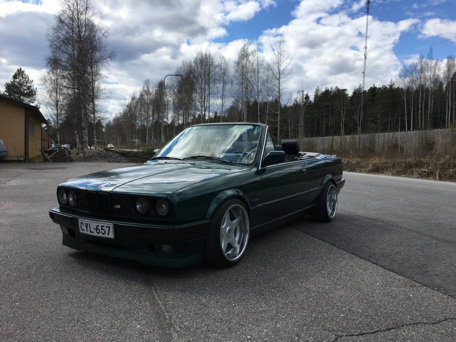

    1991 E30 Convertible 2,9L stroker
    Hi!
    Have owned this e30 for 6 years, last two years it has been under extensive work.
    Originally it is an 320i convertible facelift with individual Island grun paint. Car was also special order with grey bumpers instead of body colored :) still have the grey unpainted left.
    Car also has factory fitted removable tow hook, which is quite funny thinking the car is a convertible.
    The spec of the car is

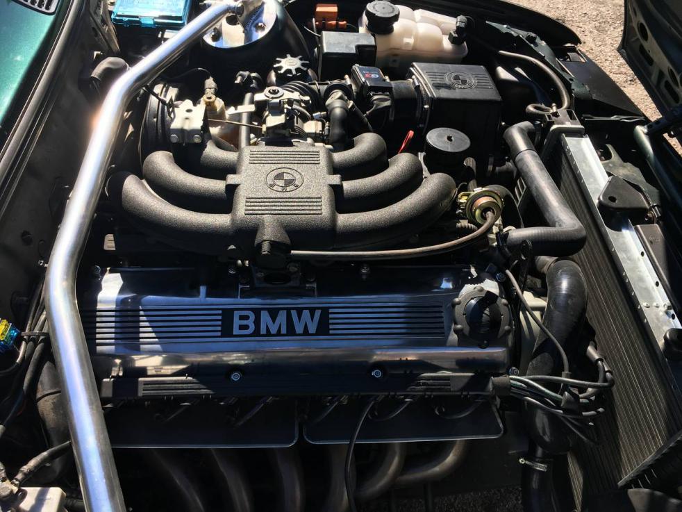

    Engine
    M20b25/27 block and 885 head
    IE motorsport Ultimate street stroker kit 2,9L with Mahle motorsport Pistons
    M50 non vanos 135mm rods
    10,2:1 compression
    Adjustable cam wheel and Kevlar belt
    Schrick 272 & HD rockers IE
    Ported and decked refurbished head
    Miller gen3 maf and war chip
    Green top injectors with 3,8 bar regulator
    Reuter motorsport header and sport cat
    Eisenmann sport
    Electric fan
    Kolb-motorsport big cooler (e32 730i)
    Drivetrain
    Getrag 245 close ratio dogleg
    Sport clutch and light flywheel
    25% locking diff
    Shortened driveshaft, professionally balanced
    Special 323i e30 tranny mount for sport getrag box
    Adjustable short shifter Schmiedmann
    Chassis
    H&R coilovers
    M3 eccentric bushings
    M3 brake master and m3 abs box
    Powerflex anti-rollbar bushings
    Aluminium strut Brace
    Reuter motorsport engine mounts aluminum cup with urethane bushings
    Copper brake pipelines
    Red46 sump armor
    Exterior
    Dark Mhw tails
    Dark side indicators and front
    Is front spoiler and rear spoiler
    Brock B1 polished 17" 8,5 and 10" 205&225 rubber
    Dark front lights
    M-tech grill badge
    Interior
    Black leather with mtech2 steering wheel
    Alpina style leather door panels
    Sport seats
    OBC
    Green strip windscreen
    M-tech gearknob and shifter
    And alot more...
    Dynoed at 201,1whp. Dyno calculated engine power 215hp and 301nm torq
