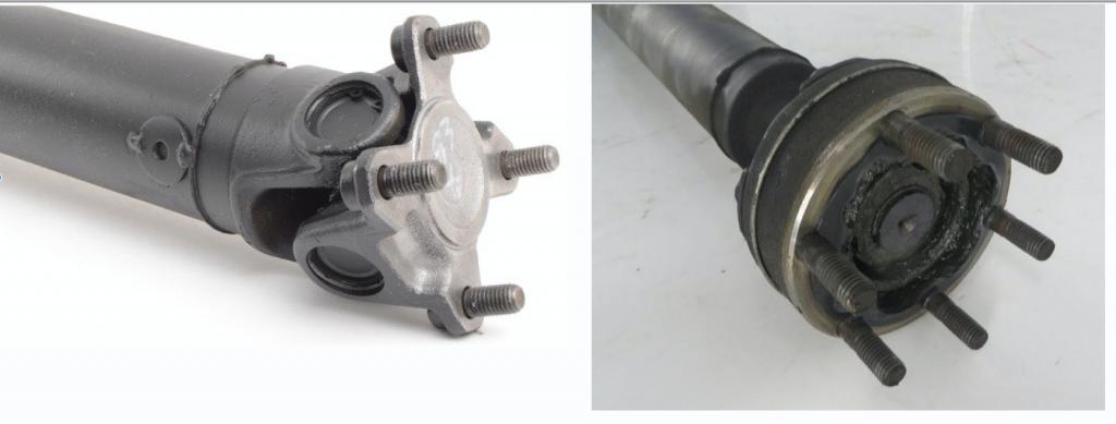

Originally posted by Cha Ching View PostKev, what's the difference of the driveshafts between the 328i and M3?
Made a little pic, hopefully it'll help others out as well. Basically the e36 M3 uses a 6 bolt flange (the drive shaft bolts to the differential with 6 bolts). I think they're are a few different driveshaft options but a e36 driveshaft from a 328i is a perfect fit since it has a 4 bolt flange identical to the e30. It's a direct bolt in swap into the car once you install a e30 center support bearing on the new e36 driveshaft.
