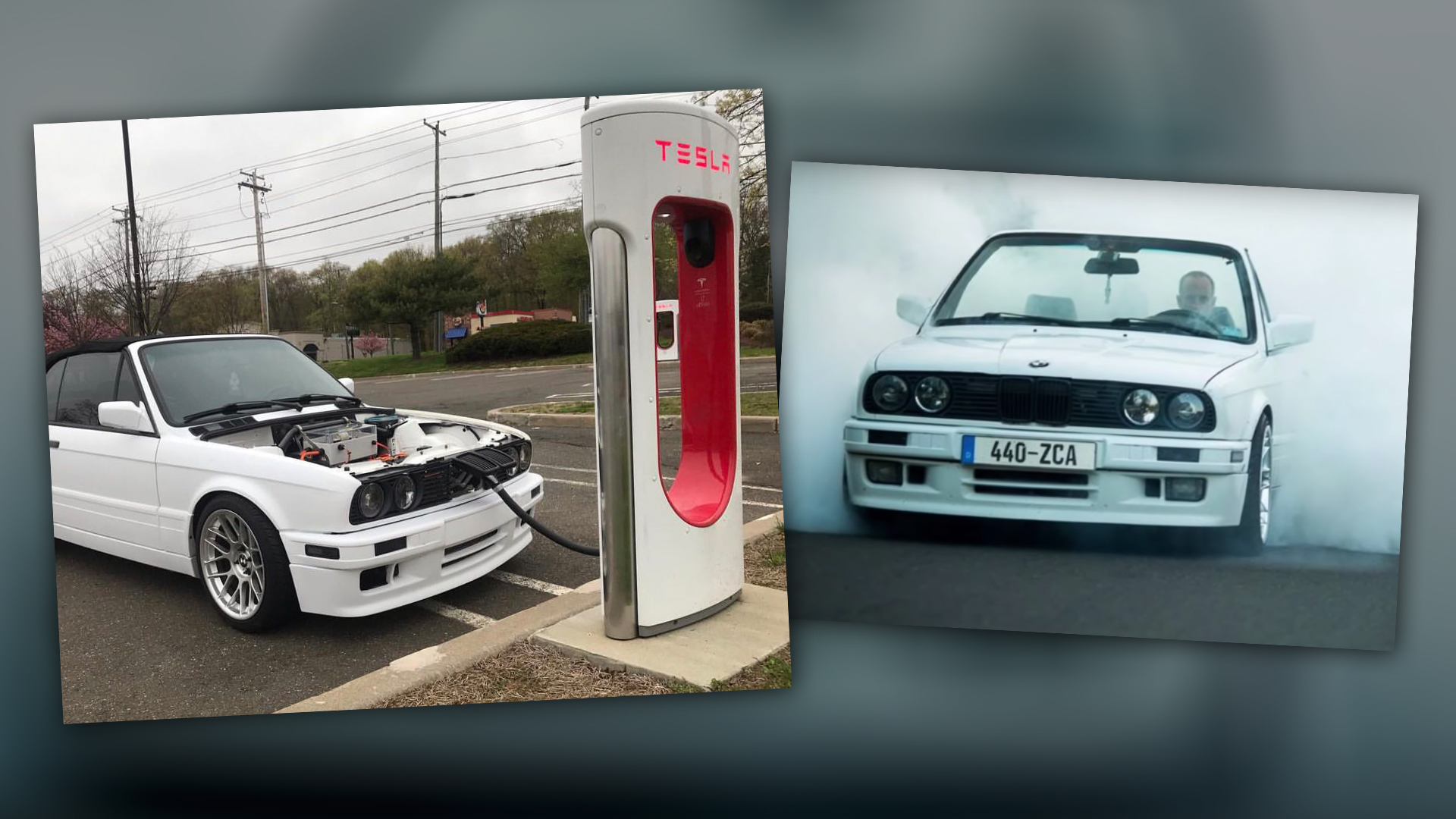

      The rear bias was intentional. The motor will regen brake in addition the standard hydraulic brakes. Its an effort to prevent weight transfer off the rear tire and loss of traction. Itll obviously help for acceleration as well.
      I already have 1000lb springs in the back to stop it from squatting every time I hit the throttle with the LS motor. Theres a 25mm sway bar up front and going to start with no rear bar. It should be fairly close to what I need.

                  https://www.thedrive.com/news/27744/...re-of-hot-rods
                  Some high level details about the car.
