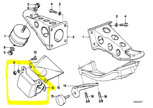

                      I had some time this weekend and after doing nothing yesterday besides watching The Lion King, I decided today I needed to do something. It was either the front rotors and pads, or the front control arms. And since the control arms were complete with New CABs already installed and I didn’t have all the stuff I wanted for the brakes I decided the control arms it is.
                      By chance I started on the driverside and I figured I’d just dive in rather than read some DIYs, I mean how hard could it be ...
                      Overall it went smooth but that upper nut that is in the subframe was inaccessible from above on the driverside and completely frustrated me. The pass side was visible from above so I thought, well once I get there it will be cake...
                      Wrong. You see , this car is original and that means there’s so many random little things that get removed and never reinstalled and I’m guessing one of those things is this motor mount cover thing. It was just enough of a pain to prevent a socket in top so again I thought I’ll have to wrench from underneath.... but there was even less room from underneath on the pass side than there was on the driverside. What I spent a long time staring at...
                      Long story short. This sh!t took way too long but I got it done. Total time was like 5 hours but I swear 3 of them were dealing with the 2 subframe nuts

                            Those two nuts were the bane of my existence for several hours recently as well. I am actually surprised you were able to get that clear a picture. With an M42 could barely see them, was mostly by feel.
                            I ended up with a spanner from below, about 10 degrees of rotation at a time because of all the obstacles, final torque with a fish scale on the end of the wrench.
                            None of the DIY guides I have seen had any cool tricks. On that note, I am amazed at how 4 lines of instructions in the Bentley manual can actually indicate 4 hours of work, e.g. "remove the bolts that secure the trailing arm." :)

                              haha glad Im not the only one who has spent hours cursing at those two. It would have been a lot easier if the "hood catch" (??- according to realoem ) wasnt in the way, but it was and I had various fantasies of destroying it in different ways

                                #105
                                What is that part supposed to even do? Its on both mounts
