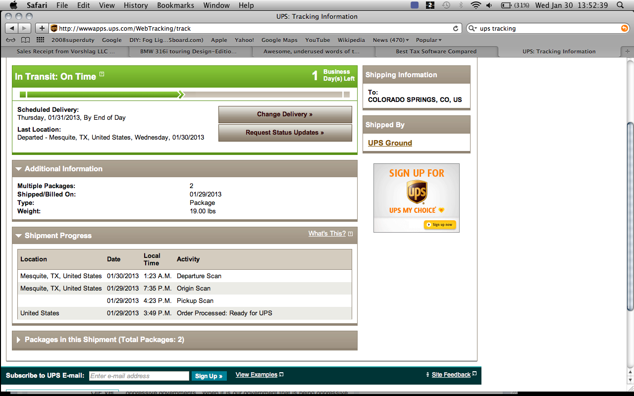

                    finally.
                      oh goody!! Cool to see this thread moving again....I skim through it every once and awhile for inspiration!
